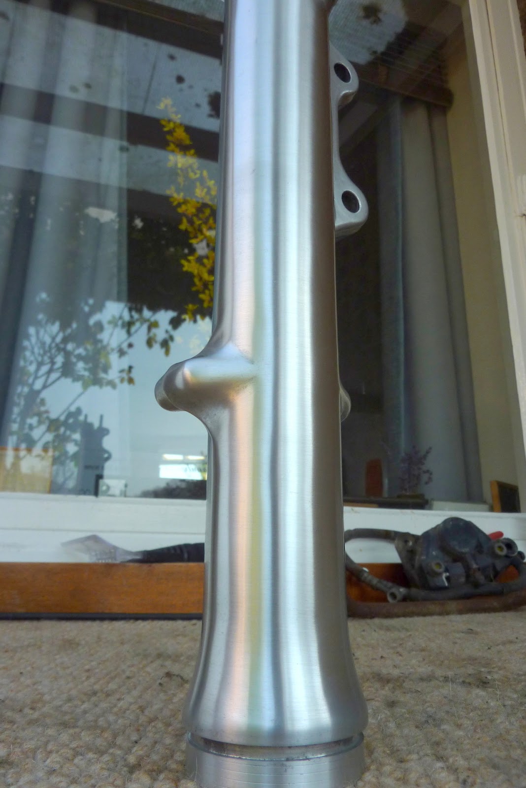

                          The finish that I like is a brushed metal or satin finish to the alloy. No original part ever left the factory with a mirror finish. I achieved this:
                          in about 1.5 hours of not too strenuous labour.
                          The problem you end up with is that in that raw state you only have to look at it and it becomes scratched or stained. Greasy oily finger marks will not come off and handling the item becomes problematic.
                          This weekend I have experimented with a clear cote lacquer and I can now handle the items again without getting finger marks all over them and risking scratching them:
                          I look at the clear as a primary protection which enables me to work with the item more confidently. It is quite possible that the lacquer will fail and that I will have to do it again sometime. But it is quite good fun (no really!). And I think I prefer it to polishing.

                            There are pros and cons I guess.
                            Greetings
                            Nice work but why experiment with clears? The odds are not great based on the consensus here at GSR. I'm lazy and don't mind doing the work once but don't want the recurring maintenance given the ocean climate I live in. Por-15 has some excellent products including a clear with specific treatments for prepping the metal. I have also used the same prep with automotive grade clears (I.e. PPG) coats for paint topcoats. I have generally done a satin finish but, I also did a polished brass gas cap with the PPG.
