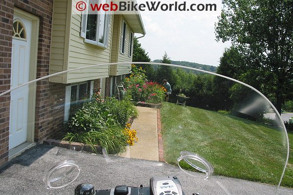

    I am in the process of cutting a new windshield for the my GK.
    I remember readind about someone installing vents through theirs. Can't fins anything with the search.
    I have found theese:
    The second one comes with the windshield.
    Did anyone try any of theese or others?
    Any recommendation for good and cheap?

    Don't expect much of a breeze when they are open.
    In fact, don't expect ANY breeze.
    The modest amount of air that does flow through them does more to relieve the vacuum behind the windshield, which will re-shape the 'bubble' of still air.
    If you are looking for a breeze, consider some Baker Air Wings.
    You will likely be the only one around your area that has them (unless there is a Wing rider nearby), but they really work.
    I really enjoy the ones I have on my Wing and on my previous Kawasaki Voyager.
