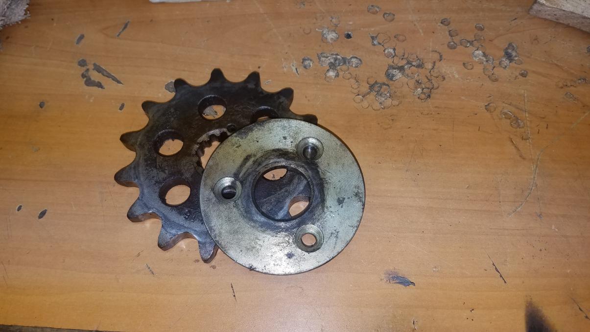

With this thread being as informative as it is I figured this was a good place to pose the question as to if I have this correct... 81 Gs1100e is the bike and I just wanted to make sure I have the sequence correct. I took off the 630 front and it was nut, lock washer, a large spacer, sprocket and finally the collar in the seal.
I replaced with these items from the outside for a 530 conversion in this order... nut, lock washer, 6mm spacer, sprocket and again the same collar in the seal against the motor. This is correct is it not? I just want to clarify for my piece of mind. One of the pics shows the large spacer that came off and I did not reuse. Thank you guys....Attached Files-1981 Suzuki GS1100E

Yes that's correct. The original OEM sprockets had a raised area on the outside (nut side) to accomodate some rubber chain dampers. Most after market sprockets do not have that and require the spacer to make up the difference as the countershaft doesn't have enough threads to properly tighten the nut. This applies to both the aftermarket 530 and 630 sprockets as the sprocket and chain width are the same.'84 GS750EF (Oct 2015 BOM) '79 GS1000N (June 2007 BOM) My Flickr site http://www.flickr.com/photos/soates50/

It works fine. Just make sure to remember that the spacer goes on the outside of the front sprocket under the nut1980 GS1000G - Sold
