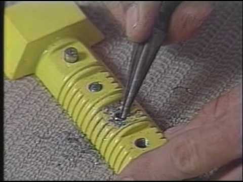

                          I have one of these sets, works excellent.

                            Originally posted by rijko View Post
                            i have one of these sets, works excellent.
                            250$ damnnnnn
                              Originally posted by Dre View Post
                              250$ damnnnnn
                              saved me from a lot more grief..
                              There are waaaay cheaper sets that do the same thing but i only found that out after i bought it.
                              http://www.ebay.nl/itm/Screw-Extractor-Easy-Out-Drill-and-Guide-Set-Broken-Screw-Bolt-Remover-AT049-/141737342672
