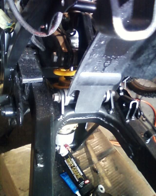

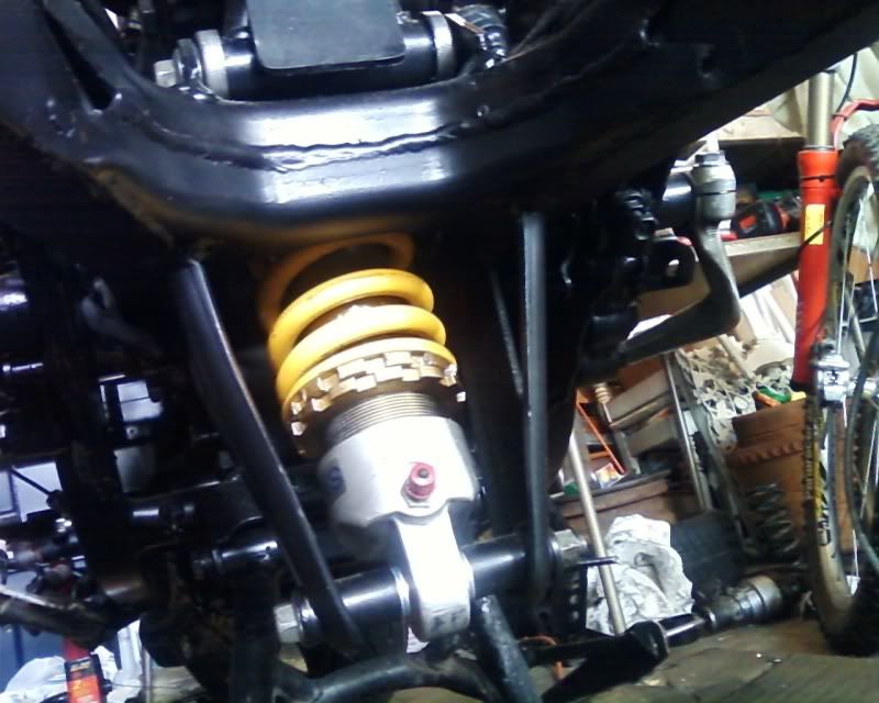

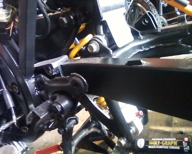

            I used a Ducati Monster M900 Shock. This shows the Ducati spring but it was way too hard (it came just about into range when I had my nephew on the back so 320lb ish total!)
            page again: http://s6.photobucket.com/user/salty...0679482&page=9
            I put the stock spring on & cranked up the adjuster as the spring length is different but it fits & works fine. It's tough to adjust this shock once fitted. You need a couple of washers for one end of it to take up the space where the axle goes through & also need to relieve the casting mark (split line) on the top of the eye. 30 secs with a file. Removes about 1mm of material...

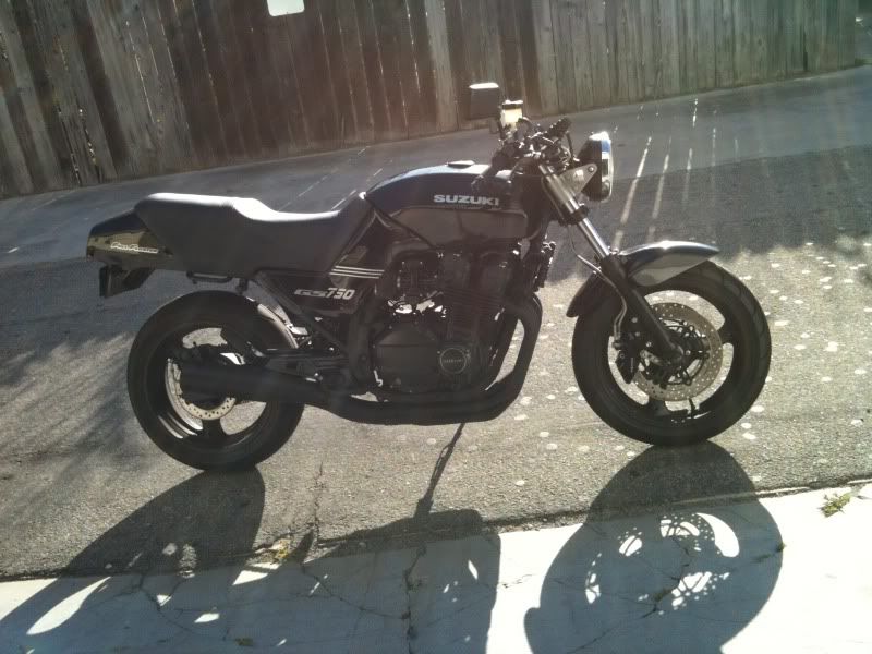

                        How it was and how she looks now
                        How it was
                        New dash
                        No cargo
                        Loaded but not everything
                        Sorry for posting just a links for the pictures, but somehow I did not find any way to put he link from google photos there...Iknow about photobucket etc....just lazy tonight.
