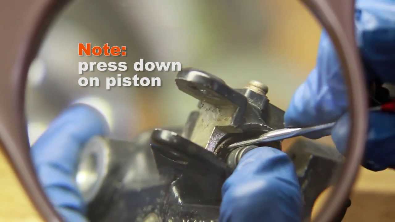

    Check again. I clearly see the remains of the rubber boot in the picture.
    Not a rubber ring, a large boot and in the picture most or all is still in there.
    Rijk

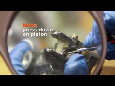

      Check 00:45

        #33
        Originally posted by Rijko
        Check 00:45
        I already removed that. Tapping a screwdriver on the bottom of the piston hole makes a metallic sound.

          OK good. Like Steve said, there probably is a washer corroded to the cylinder wall.
          Can you now see that washer ?

            #35
            The washer has been removed as well.
            The circlip, washer, and rubber boot ring are all out. It's just the piston in there now. There's just a metal ring, with a depression within that, and the piston in the center.
              #36
              That's it, I'm drilling the darn thing out. If it breaks, oh well. The plunger is wedged again, so I have to remove the whole plunger assembly by force. I'm trying to drill through the metal ring that's in there, but it's thicker than a washer.
              As I stated, if you look at the plunger, it appears to be surrounded by another metal ring that appears fused to the plunger hole walls, yet no amount of banging on it with a screwdriver and hammer will remove it. In the video, the plunger seemed to knock against that. It's an Aisin master cylinder with a number 14 on the bottom. Did this model of master cylinder have a fused plunger assembly, like it was stuck fast to the body? It seems like they're one whole unit, not meant to be separated.
              I'd like to keep the original look, but if I can't remove this plunger, I'll have to go aftermarket, which includes finding a way to make the taillight work again (I'll need someone to explain that to me).
              EDIT: After pounding on it with a bigger hammer and screwdriver, the plunger assembly seems to have recessed further into the body. It shows it can move, but it went in the wrong direction.
