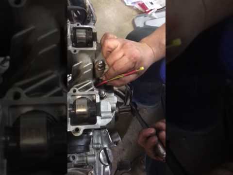

          You should be able to see the valve before you put in the zip tie. It will get pinched quite a bit, yes, but should hold up fine.
          IIRC, I didn't even fold mine, just bent and shimmied it between valve and valve seat by feel.
          Here's a vid that somebody did a few years ago:

                    I used to always use the tool but I now swear by the zip tie just because of how often the tool will slip off.
                    Oh, and Steve and I did that video Roeme linked to again

                      Hah, that confirms my suspicion that the vid has been done by forum members!
