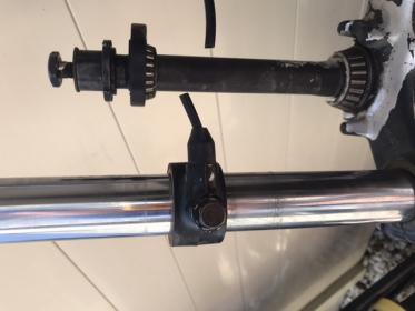

1982 gs1100e front forks?
    Do these rings for the front shocks come off? If so, how?
    TIA

    That is the air fitting, the line to the other one is cut. They slide off but make sure the tubes are cleaned in the direction you are removing as they are a tight fit. Inside are two rubber o-rings. Squirt some liquid wrench and gently twist a bit and lift and they should come off easily.

      Thank you! The bike sat in a back yard for ten years. Everything is a little tight.
