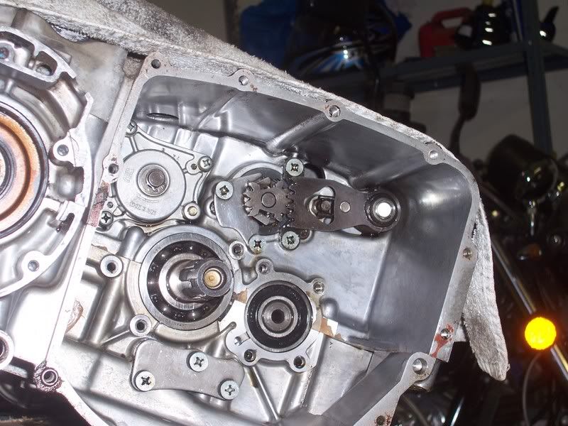

    I searched, but didn't find my answer. I have the cases ready to split (I think) so as to remove the crank for welding. The manual says I need to remove the cam driven gear shifting pawls #1 and #2. Do I really need to? I took out all the screws that hold the plates that are on both sides of the split, but not the gear shift cam guide screws or the gear shift pawl screws See pics. Do those screws need to come out? What else do I need to do. I gave the cases a few blows with a rubber mallet the way it is now, but nothing budged.

    http://alpha-sports.com/spst/1978%20GS1000C,EC/12.gif and http://alpha-sports.com/spst/1978%20GS1000C,EC/33.gif are pickys of that area that may help. I know its a tender time. You should be right there to split it now. Have another look for all the bolts making sure you havn't missed one then continue with some more gentle persuasion. Enjoy

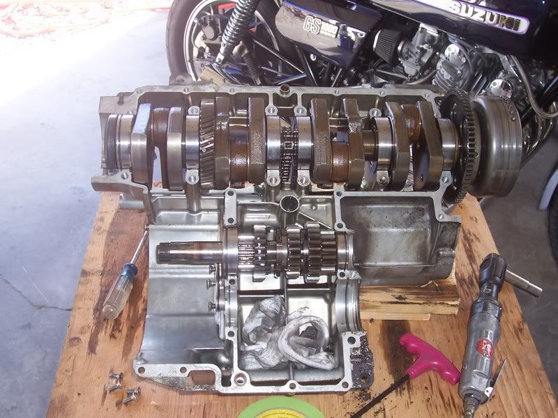

      Cases
      Make sure u have all the bolts out including the 10mm nut behind the front sprocket. The dowels (no 2) will be tight so it might reguire some(but not tio much) force. The pic is for a early 1000 but im sure there almost the same. Those plates dont need removing but one is a oil gallery and woulnt hurt to clean that out anyway. The shift forks remain in.
        Thanks for the input. I looked at all the drawings, but could not see why the manual wanted those screws removed, or why the pawls would need to come off. I'll go out and give it a few more whacks. Also, the manual makes no mention of using any kind of sealer when putting the cases back together, but you can see that sealer was used originally. Should I use a sealer? What kind? Suzuki Bond?

          cases
          Any good sealer will do but suzuki bond is one of the best. While ure in there may i suggest you get 2nd gear welded and its only a press fit and sometimes it can spin. Any good performance shop will know which gear i mean as i cant really remember which shaft its on, sorry.
            Bruce, like Sharpy said, make sure you have all the bolts out. There are actually 2 near the countershaft sprocket, one just in front of and one just behind. I have always preferred the Yamabond for sealing the cases as it is light colored ( like the factory uses) and seals very well. Welding 2nd gear (on the input shaft) is probably not necessary unless you are planning to run it at the drag strip. I would be tempted to go with Gardener Racing Concepts for the crank work as he is highly recommended by Big Jay and I have not been totally satisfied by the work done by Falicon in the past. He also does clutch basket mods/repairs and this would be a good time to make sure the basket is in order. Dont know what kind of manual you have, but the Clymers manual does not mention removing the shifter pawl for splitting the cases.....BadBillyB

              Got it!
              I had all the bolts out. There is a spot right next to the front sprocket where on one side of the case is a small hole...like a loop, and on the other side it is flat. I put a small nut in between those pieces and a bolt through the side with the hole. Tightened it up just a little, and pop! they separated a little. Then I used a paint stir stick as a pry bar and gently pried around the cases, helping the cases to come apart. There is a pin in the front and rear that the cases need to slide off of. I'm using a Suzuki shop manual... I don't know why they want you to remove those screws.
