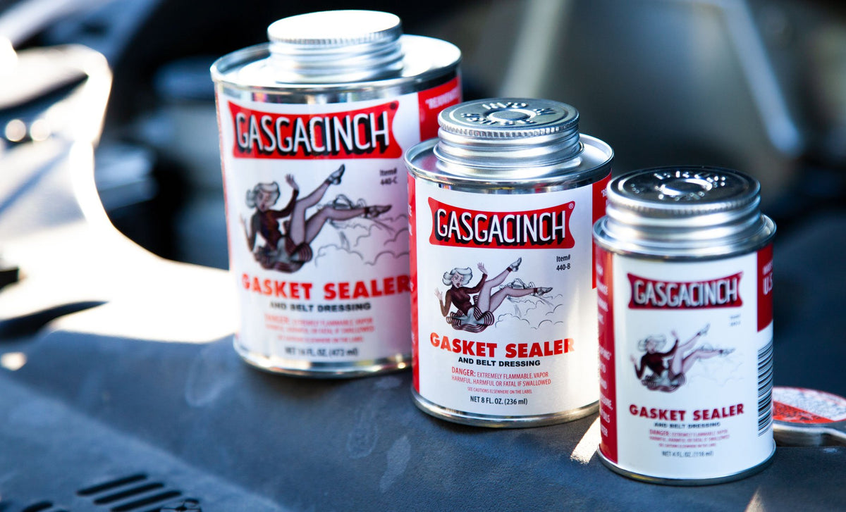

                    • relic-rider
                      I use Gasgacinch sealer on my gaskets. I first used it on the intake manifold gaskets on my 72 Chev. pickup. The Edelbrock manifold I put on recommended it to seal better. Works good and makes removing a gasket later much easier. I had to go to a Harley shop to get it then. Most bike shops have it. Bike Bandit, Dennis Kirk, etc. also have it.
                      Gasgacinch products serving customers like you for over 50 years. Our products represent performance, durability, and quality. We provide products direct to distributors and retail stores. Become a vendor today!
                      • runewolf
                        OK, dumb question on the Gasgacinch since I'm having problems finding it locally... What I have found locally is called Edelbrock Gasgacinch Gasket Sealer. Is this the same stuff or another brand's knockoff? I doesn't have the Gasgacinch falling girl logo on it as seen on their website?
                        • runewolf
                          Well found out that the Eldelbrock stuff is the same as Gasgacinch, Gasgacinch private brands it for Eldelbrock... The local shop sold thier last can, now I can't find either one.... So now I'm looking for something else to use
