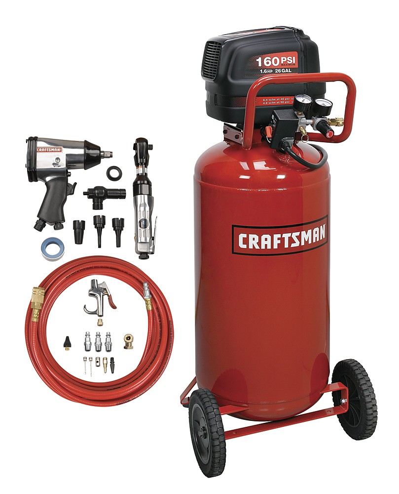

    Would it not be wise to use air tools on the bike? Are pneumatic tools too powerful for loosening screws and bolts on these old bikes? Specifically I'm wanting to use my new impact driver to loosen all of the case bolts and replace with with Allen's heads.
    I'm also assuming it's not a good idea to even think about tightening with an air ratchet.
    This is the one I got along with a better air hose.

    I use air tools on my bike on a regular basis. Invest on some 3/8 drive tools. Save the 1/2 inch stuff for the heavy work, Start slow and only increase power if needed. On assembly, keep the setting at low pressure then finish by hand. When I wrenched bikes for a living I would use air on everything coming apart and going together. It's a matter of knowing the tools capabilities so you don't wind up breaking things.

      The impact driver you hit with a hammer is what you need on your case bolts. An air impact driver is a completely different animal and won't do a bit of good on your case bolts.
      The reason for using the hammer-driven impact is that the force of the hammer blow forces the bit into the cheez wiz phillips screw head and applies a shot of torque at the same time, hopefully cracking the stupid thing loose so it can get chucked in the garbage. An air impact just applies torque with internal hammers.
      With that said, I use air tools all the time in mechanical work on bikes and cars. You can save a lot of time and effort, and in many cases it's much safer to use an impact than to try and brace things against the torque of a steady pull. Many times, when something finally cracks loose by hand, you can bust a knuckle or worse, so you can avoid this with air impact tools.
      But in any case, do NOT use air tools on your motorcycle until you thoroughly understand how they work and what they can and can't do. Practice on Chevys and other less important vehicles for a while first.
      I'd also encourage you to track down a quality 3/8" drive impact gun -- they're surprisingly hard to find -- and use that as much as you can instead of a monster mongo torque 1/2" drive.
      And make sure you get a quality high-torque (500+ ft-lbs) 1/2" drive for car work -- when you need it, you REALLY need it.
      Also, if something hasn't been apart before, you're often much better off to break it free by hand, especially if it's a delicate or irreplaceable assembly.

                Just so you don't waste your time and money, make sure any tool that you do end up buying, matches up with the output of your compressor. I think you will find that you cannot run a very high torque 1/2" impact with the compressor you have. The impacts, along with every other pneumatic tool, will show you an scfm rating at 40 and 90psi. If you get an impact that needs a higher output then what your compressor will put out, the impact will not work efficiently or give you the 500+ft/lbs that you are expecting. As for a 3/8 impact, you should be able to go back to the Sears you bought the compressor at and purchase one. One other tip, make sure to purge your tank after you use it. Water will build up inside the tank and can eventually rust through. There is a petcock on the bottom of your tank you can open and close to accomplish this.

                  My air ratchet (the one in the picture) isn't adjustable (just immediate power.) Do I just manage it's torque at the tank via the outlet pressure adjuster doodad? Also in it's manual it says to tighten until the ratchet stalls and then manually tighten with the ratchet in place. At what torque is it stalling?

                        The air ratchet isn't really for applying torque via compressed air. (At least mine isn't!) Not like an impact gun, anyway. It's mainly for speed, for running long bolts down into place for items like cylinder heads, etc., when you have a whole bunch of turning to do. The air ratchet won't tighten or loosen the fastener, at least not much.
