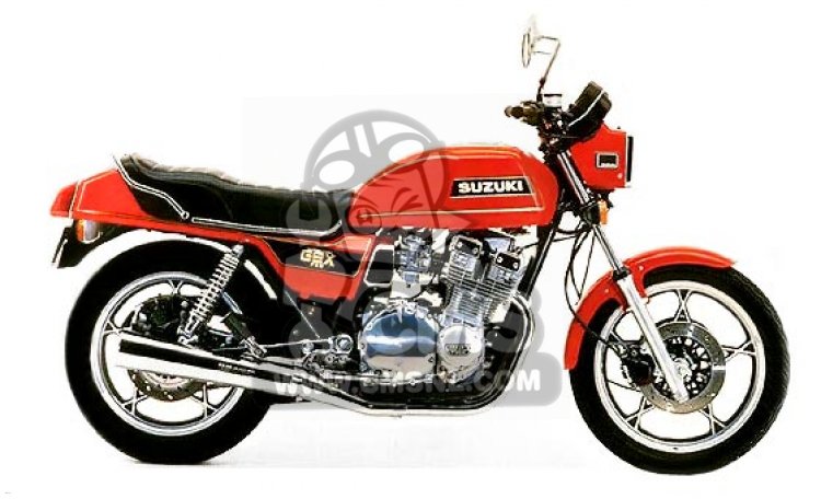

    Howdy folks;
    Lookin for the Suzuki part numbers for front and rear sprockets off a GS750 or 700 from 83-85. Reason I ask is that I'm fixin to order a chain and some sprockets for my 84 Katana (which is basically the same as the above mentioned models). I'm kind of debating about keeping it all stock, versus swapping for newer Katana (GSX600/750F) forks/wheels/brakes.
    SO, with that said, the part numbers I have are as such:
    14t front sprocket: 97511-47100
    43t rear sprocket: 64511-08A00
    Mind you, the numbers I have are Genuine Suzuki part numbers, listed in the Suzuki part fiche. To answer my question your numbers must also be Genuine Suzuki part numbers, pulled out of the factory parts microfiche, not Bikebandit or somewhere else. Further complicating this is the fact that I can't simply go to Bikebandit and compare their numbers between models, as they don't list a 1984 GSX 750SE.
    Also, my owners manual calls out this chain:
    DID 50V or Takasago RK50G0, 114 links. I believe this is a 530 o-ring chain. Can anyone verify this for me?
    Basically, I'm trying to decide whether or not I can simply order parts to fit an 83-85 750/700 and mount them up successfully on my 84 GSX 750SE.
    My questions arise from a discrepancy between the 83-85 750/700 front brake calipers being different from my 84 Katana 750 calipers. I assumed they were basically the same bike, and they are, but I need front brake pads off an 85 GS550ES, and rear pads off an 85 GS700.
    Oh the joys of owning a foreign market motorcycle.....
    Any help is super appreciated. Clear as mud?
