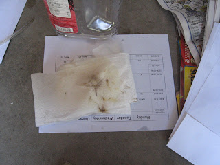

Heres a picture of the "gunk" out of one of my carbs.. they were all pretty much the same as this

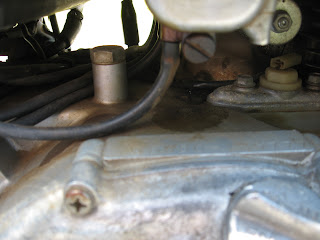

What is the hose coming out of the bottom of the carb float bowl? Also, should the small amount of gas (leak) worry me?

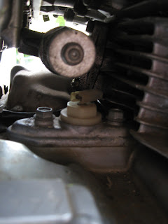

What is this wire going into the plastic head in the following picture? It seems to be able to just slide out
Is there way to clean the plug threads, or anything I can drop in here to clean it up?Cheers,

It's impossible to see the threads on your cylinder head, but if need be you can run a thread chaser (very carefully) or tap to clean up the threads. Make sure you buy the right thread size and pitch. I'm thinking 14mm X 1.25mm? Fuel flow looks good and donating that gas is a good idea. That may be why your plugs look so bad.

Are the plug threads messed up by cross threading or do the plugs spin in easily unitl they are nearly seated?
you can chase the holes with a tap but I think you need one specifically for the purpose as the holes are likely tapered.
im not sure about the float bowl tube but the connector is likely feeding the indicator light for your oil pressure indicatorLast edited by Guest; 07-13-2009, 09:08 AM.
Suzuki_Don
The float bowl tube is an overflow tube to bleed of excess fuel if the float bowl overfills. The wire is to the oil pressure switch.

Prosolar - Does that gas look bad?? and im glad you found your cover
Calvin - are you saying that supreme gas is worst than regular for the motorcycle? and for the tank cleaner, I have a bottle for my car.. how much should I put in my motorcycle and are all kinds safe? and the plug threads are not damaged just dirty (with soot)

soot in the plug holes is pretty normal if you can readily install and remove your plugs then do not worry about it.
