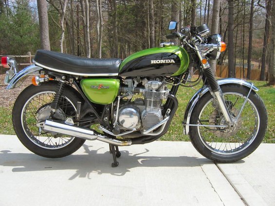

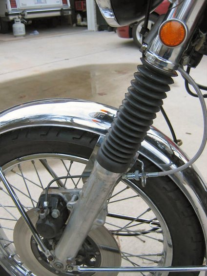

        This past winter I redid the entire front end on my '71 CB500F (both brakes and suspension) because it was shot. Based on my experience with the GS, I knew I wanted to use the stainless steel lines and Ferodo Platinum pads, but I wanted something different on the master cylinder, because the 'on/off' wooden feel of a large bore master cylinder is no fun.

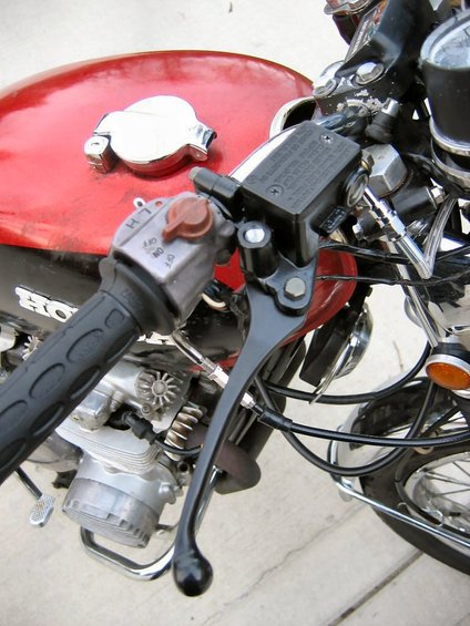

        I found a new aftermarket replacement master cylinder for a Kawi EX250/500/KLR650 on Ebay for a song, $40. I checked and the those Kawi bikes all used a single rotor brake system, so I knew I'd be very close with my CB500F, because it's a single disc too. (What I did not know is the caliper side for the EX500.)
        I lost the email with the Kawi EX250/500 master cylinder bore size, but it's near 1/2" or slightly smaller and I imagine it will work fantastic on any single piston / caliper GS.
        The result? Fanastic brake feel. I have to pull the lever a bit farther than before, which was almost scary at first (thought I had no brakes!) but once you're on the brakes you can adjust for ever so slight braking to full stopping power. It's awesome.
        I encourage this upgrade to everyone, but it is going to require some work on your part to find the appropriate ratio to target and then the right master cylinder. Micheal Moore from Vintagebrake.com is a great source of info - call him up.
