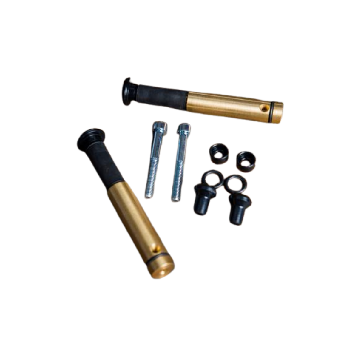

https://www.barsnake.com/ - These do work but not as well as very heavy bar end weights in my experience.
