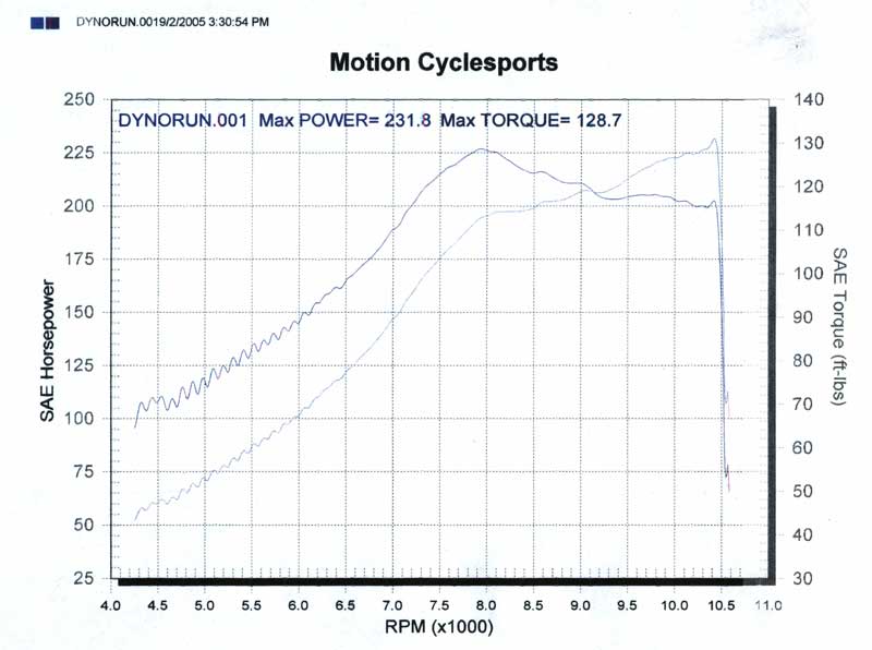

Originally posted by isleoman View PostI'm pretty sure your right that 150hp would be at the crank for an older GS design @ 1135cc without a turbo. Although I'm not sure I would bet against Yoshimura they may be able to do it.
I would have said that you would need a more "efficient" engine than a bigger engine, since current GSXR750 and 1000s are pushing around 150 / 168 at rear wheel.
Do they really have 168 at the rear wheel, Surely thats at the Crank?!
Wouldnt they have to be pumping out something like 185-190 at the crank to get 168 at the wheel?!
Anyways, V&H had a GS1100 instructional Video out in the early 80's.
The mods were 33mm Smoothies, V&H (345?) Cams, No mention of porting, 1170 kit, V&H Header & Pipe.
At the gearbox they got 130 @8000rpm, 143 @ 9000, 151 @ 10000.
Im presuming thats around 128hp to 135hp at the rear wheel which is about right based on some of the dyno sheets guys have put on here?

Originally posted by Silvermachine81 View PostDo they really have 168 at the rear wheel, Surely thats at the Crank?!
Motorcyclist dyno'd a 2006 GSXR1K at 159.8hp at 11500rpm and 79.2ft-lb at 9750rpm. Again, both numbers at the wheel.

Gpz1000_Convert
126.9 bhp
84 ft/lb
1240 wiseco efe, rs 36, one off (very free flowing) pipe, mik rs36, dyna S, Dyna coils, taylor leads.........
chrille_08
140,5 hp @ 8300rpm
106 ft-lbs@ 6500rpm 95,9 ft-lbs already @ 4000rpm
All measurements at the wheel.
