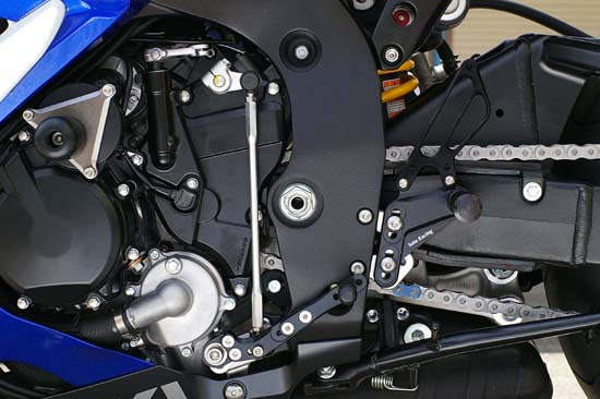

      Notice the way the shifter is set up in these pics.
      06 1K:
      06 600/750:
