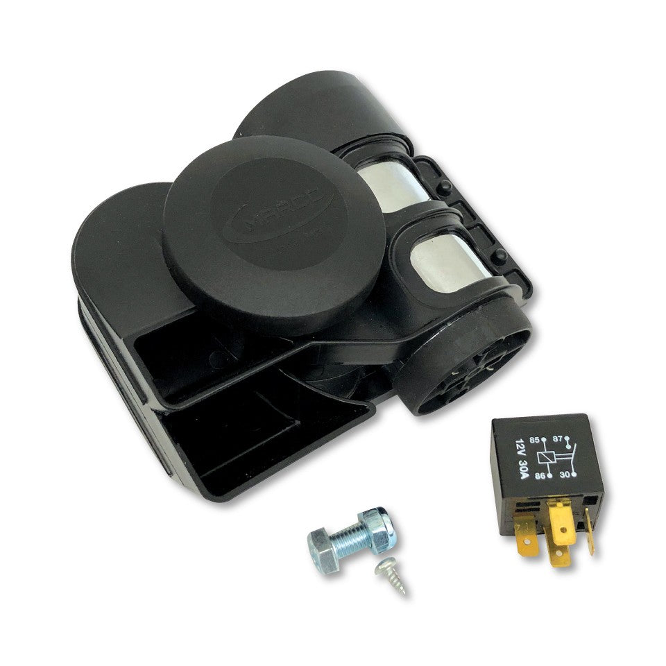

    Has anyone ever installed one of these ? Yesterday on the freeway, a car in the right lane slightly ahead of me, shoulder checked and then pulled into my lane narrowly missing my front wheel. I hit the horn and shook my fist. But the polite beep beep of my Suzuki horn was not truly expressing my feelings. I think this one might.
    This is a full-power railroad locomotive/ocean liner type compressed air horn squeezed into a bike-mountable package. Totally overkill, until you need to wake up some lethal driver.

      So... It's even louder than FIAMM's freeway blaster? I guess you could try it out.

          Heavy, ugly, lousy mounting system, hard to install in a tidy manner and short lived. But they are loud.
          The Fiamm Freeway Blasters are plenty loud as well. I have both types.

          Go to your local boneyard and get a couple of old car horns and a $3 relay and Bob's yer uncle.
          On second thought, tally up the times you actually use your horn, and don't bother. I installed the originals on my GS1100 after cleaning and adjusting them, and they are actually pretty loud for stock horns. Like I said though, I maybe used them 3 times in 4 years of riding it, mostly to alert drivers that the light had changed.

                        For someone like me - who is completely "electrically-challenged", is it preferrable to splice into the existing harness with the relay, or is that to get the stock horn button to work the horn for convenience? Could you just mount an old fashioned button (with a relay) on the handlebar?

                          You take the leads from the stock horn and attach them to the relay contacts that actuate the relay itself (#85 and #86). Then you run a lead (with a fuse) from the + side of the battery to the normally open contact of the relay (#30), then run a feed wire from the other side of the normally open contact (87) to the + side of the horn. See the diagram below. Some bikes use the OEM handlebar switch to ground the circuit, others use the switch to send power to the horn. On my 1100, there were two wires, one + one -. On some bikes, there is only one wire to the horn, and it is grounded through the mounting bolt. If you have two wires to your horn, they go to contact 85 and 86 to actuate the relay. The horn power draw goes through contacts 30 and 87. If you use powerful horns with the stock switch you will burn the contacts with the heavy arc created by the high current. The relay is made to take the abuse.

                            I have a wolo bad boy (the same horn as this thread) on my GS 650 motorcycle and my corolla. I also recently inherited my wifes camry when she got a minivan, it has the stock horn. The stock horn is ignored MUCH more often than the air-horn on the corolla, despite the corolla being a smaller car.
                            The air horn on the motorcycle is VERY effective.

                            Will an airhorn increase your odds more than any other horn you can put on the bike ... I'm absolutely convinced by personal experience that: yes it will, sometimes dramatically .
                              Don't forget that weak stock horns can sometimes be brought back to life by twiddling the small adjustment screw. Just work slowly, running the horn while you adjust, or you risk going too far in one direction and halting oscillation. Not a catastrophe, as you can usually get it going again, but it's easier to do while running.
