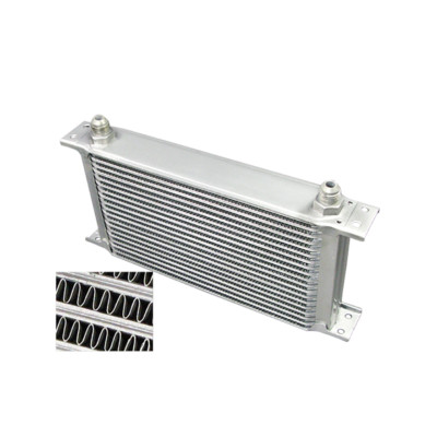

Found this cooler on ebay much cheaper than Earls:
