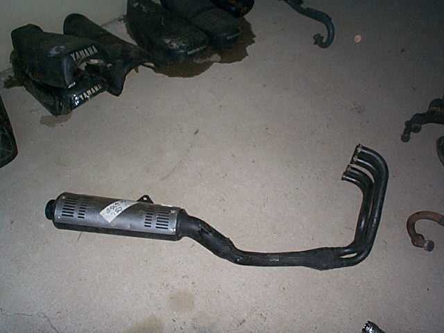

    Would the 4 to 1 stock exhaust from an 86 GSXR 750 fit my GS700ES?
    Here is a pic of the GSXR exhaust...
    My GS is an 85 if that helps anyone.
      I bet the heads are different, but you could always look each header up in the parts fiche and compare them.
        good idea cableguy, thank you I will do that.
          If you have the exhaust in hand, why not do some measurung before spending time doing research. It may be quicker...
            you are 100% right about the measuring bit. however I do not have the exhaust in hand. It was a pic from the seller, plus the head from the GS700 to the GSXR750 are way different.
              This was recently discussed on the exhaust forum.
                The 1st Generation GSXR 750 exhausts are an near perfect fit for the 83-85 GS700/750 E/ES bikes.
                  Well then, thank you for that. I will go check it out soon.
                    There are not available anymore, they all sold out but this should give you an idea of fit.
