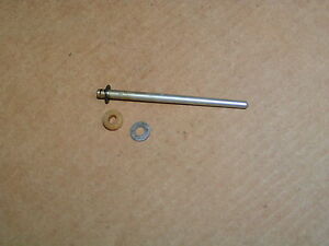

            Now, this is something I've been confused about since I picked up this bike. Never worked with CV carbs before, but the needles that were in my set look like this:
            Except, mine are even more tapered. So pointy, they almost look like toothpicks... The PO had obviously been in the carbs before, but it wasn't clear to me what had been changed. I cleaned and rebuilt them, but left the needles not knowing any better.
            After so many hours trying to get this bike to run right, it became apparent that I might have the wrong needles and that these 5D50s are what should be in there:
            The 5D50s look a hell of a lot more like the DynoJet needles that came with my kit too...
            You told me to raise the needle using 1 washer, which again raised a flag--my needle has clip positions. Am I right to conclude that I've been running the wrong stock needle this whole time?...
              By running it ONE washer higher, I meant to replace the factory plastic spacer with (4) 3mm flat washers which effectively raises the stock jet needle ONE washer or .048-.052mm

                Got it. Still, which needle of those pictured is the one that I should have in my BS34 carbs?
                  I would start with the factory needle as that is what I was working around with my suggestions. With the various different needles that you currently have on hand,
                  I would think that you have plenty of fine tuning options besides those.
                  I have a Dynajet replacement kit that I bought years ago (practically free) to compare what they suggest with what works for me and have yet to have the desire to do a thorough investigation.
                  Some day I will get out the micrometer and compare the parts myself. I just have no immediate need to do so.
