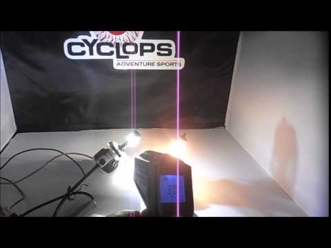

                  This video shows the Cyclops running at about 88 degF at the bulb and 95 degF at the fan. Compared to the HID which is close to 320 degrees. Seem like the fan is may not even be necessary.
                      The last line of the video:
                      "And that's after running about 5 minutes, ... in stagnant air."
                      Even "stagnant" air has a fair amount of cooling ability, I would like to see the same test with the bulb (and the fan) closed up in a headlight bucket.
                      And, ... it's not about the absolute temperature, what really matters is what the light can tolerate.
                        Air is actually a good insulator, that is why down jackets work so well. If you close it up it will probably run cooler as now you have the lens to conduct heat away. Even if the air is trapped inside of the bulb preventing convection, heat still conduct out through the housing. So you are comparing the additional cooling effect of the rising heat in stagnant air v.s. a closed volume conducting heat out. It is probably a toss up and at 95'ish degrees I don't think it will ever get so hot you can not touch it.
                        As per the 5 minutes, there is not enough thermal mass there for it to take much longer than that to get to thermal equilibrium.......... I'm guessing they already tested it and now that 5 min is steady state.
