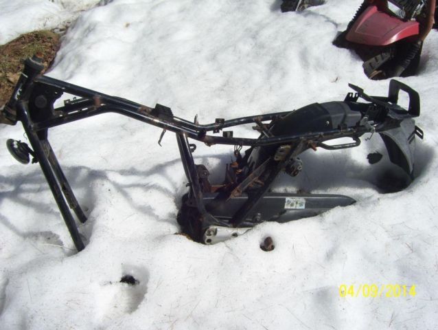

      I don't have any experience with the earlier 400 frame but I do have a fair bit of time with the later 450 frame - which is the layout sitting in the snow.
      For most racing the 450 is pretty good without extra bracing. If you're really serious, the lack of crossbracing at the front and rear engine mount areas can be remedied easily. Under race loads, the stock swingarm could do with bracing too.
      I do see what you mean about the early vs late steering head tube layout and agree it is a potential problem easily fixed.
      Oh, and i've built and raced Aermacchis too - including exporting a couple of my frames to Canada.
        The new frame is what the original frame should have been. Unfortunately, if you have or want an early one you have to pay the handling penalty, which isn't huge, but just annoying. If what I'm suggesting works it is pretty easy to do even on a built up bike. Certainly worth a try.

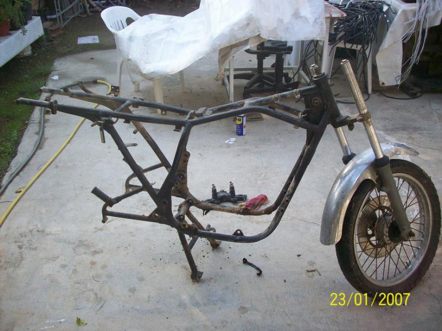

          This is the most common way of bracing a 4 cyl GS frame. A lot of it you could also apply to the twins.
