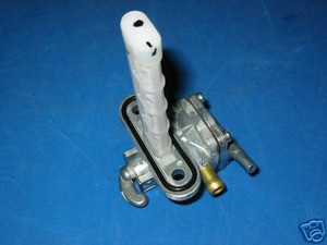

        The prime doesnt work on my petcock.

          If your prime doesn't work, there is a good chance that your petcock can't deliver enough fuel to carbs, get new petcock for $60 or so and rule it out. Z1 or this florida guy
          He also has cheaper one with less reserve which is what I wanted

            You can test the petcock to see how much it flows. It should be full flow through the hose, not dribbling.
            Any chance you have an inline filter in that fuel line?
            Those restrict fuel flow quite often.
