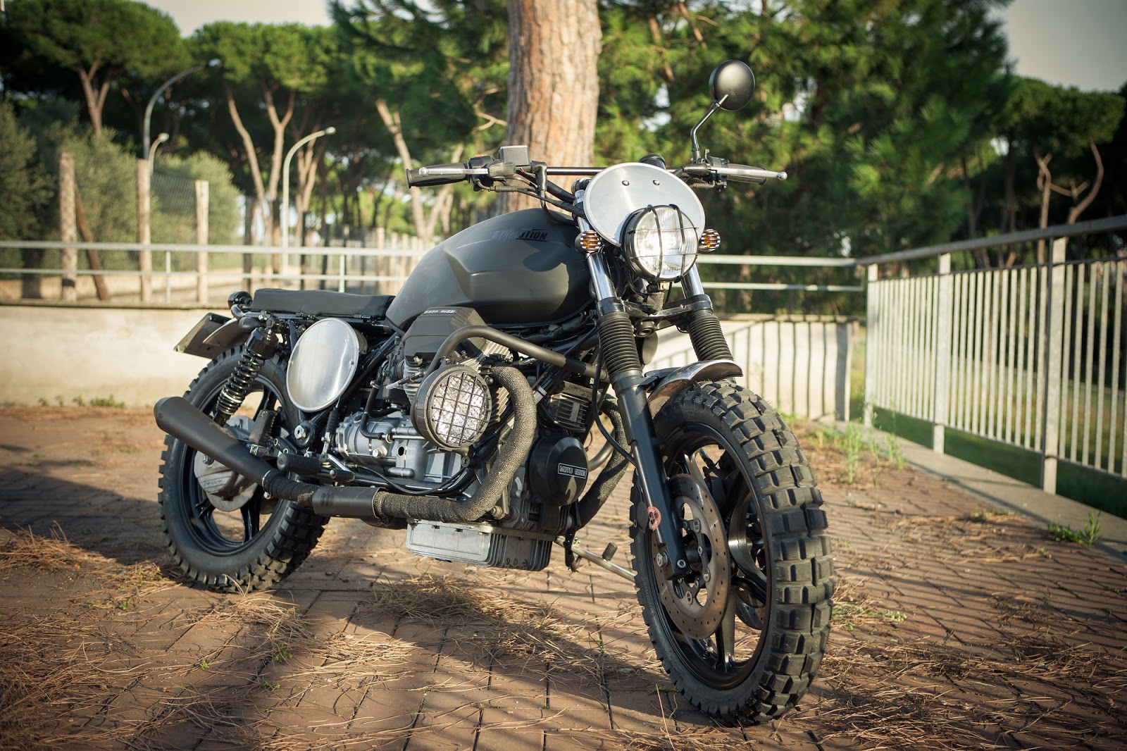

i could pit a sqare four of the aforementioned...
And, I can tell you, is pretty confortable, both in the way of stress to the wrists and actual sitting position.
Hard hitting on the pockets though, with a mere 7Km/L (drove on the pipes)
