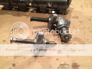

              Personally I would just get a manual tensioner or fabricate your own like I did, could be a combination of a slightly stretched chain along with a sticking / faulty tensioner.
              Here are some pic's of the one my machinist and I made.

                      Nice piece you have there - very functional.

                      personally i would just get a manual tensioner or fabricate your own like i did, could be a combination of a slightly stretched chain along with a sticking / faulty tensioner.
                      Here are some pic's of the one my machinist and i made.

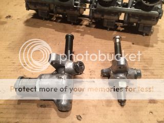

                          Pulled tensioner knurled nut off today as I felt the tension was inadequate, wound it 1.5 turns tighter preload, feels much better now.
                          Stock GS750 cams. Resurfaced head and cylinder block, thought I should degree the cams on engine rebuild, but didn't yet. I notice my arrows don't quite line up as they show in the manual, I suspect due to the resurfacing milling job I had done on both.
                          I thought I had a stripped thread on the tensioner spring winding shaft, felt as hard to loosen as tightening. It turns out I must've used some serious threebond semi-permanent hitemp thread locker on it as I recalled after the fact. I got it for internal engine parts. Hope I am able to get those apart again if I ever need to! That stuff was seriously stout...
                          I noticed the gs550's tensioner felt slightly firmer on the spring than mine was, but also noticed binding stiction on the wedged part. I recall reading bwringer's tutorial saying that often the wedge angled ends get worn down unevenly and need a light sanding or filing to clean up.
