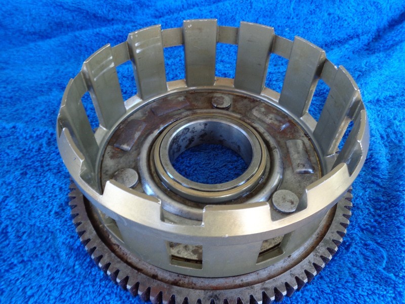

    Well the guy with the Falicon bullet basket and straight cut gear now informs me he also has a GS1150 MTC straight cut gear and OEM 1150 basket... I know the rivets to assemble the backing plate are slightly larger on the 1150. Would all of the 1100E/1100G parts fit on the 1150 basket?
    I also have another guy with an MTC billet basket that has a broken spring, but there is a bit of rust pitting on the inside bearing surface where the large roller bearing cages ride... that had me a little concerned as I don't want to compromise the fit and wear there.
    I may get both in hopes that the 1150 basket straight cut gear is the same as the 1100/1150 old mtc billet basket. Thoughts?
    Rust:
    Billet MTC basket???? I thought it was odd that it was still just riveted, not welded. Green springs were definitely not stock as far as I know, however... I've not seen a basket that looked like this in a 1000, 1100, 750, 550, etc... other "billet" baskets however all seem to have the bottom inside piece that the rivets are pushed through as one single piece with the outside portion. This has the inner portion as a separate steel piece (?)...how does that work? Must interlock very well into the outer basket portion...

      • sharpy
        One with the rust ill just walk away, thats a no brainer for me, sorry to say

          I was thinking if I could get it for a good enough deal, just swap the gear on it (bearing surface is integral to the gear if I recall, right?) With another. That's why I was asking if the 1150 gear would work on the mtc basket...
          Also wondered "just in case" if the 1150 setup would take all the rest of the parts from my 1100G basket.

                        Why not remove the rust with an electrolysis process(or other). It will surely remove material and not leave any deposits. There is plenty of tooth material surface area even if there is some microscopic pitting. From here it looks liek mostly surface rust.
                        • Chuck78
                          • 3692
                          • Columbus, Ohio
                          Because at pushing around 110 horsepower on a bike that will get ridden very aggressively, and with a brand new crank gear on a welded crank, I was afraid to mesh a brand new crank gear with a basket primary gear that was no longer to the original surface spec and may have uneven surfaces due to rusting. Not worth the risk for a crank that would cost me $1400 to replace or probably $500 in crank labor/gear only to tear down and put a new gear on if anything really bad happened to it.
                          it looks pretty grimey in this shot, the rust on the faces of the teeth. I looked to confirm the seller's rebuttal, & even on the aftermarket baskets, the bearing surface on the inside that has very slight rust staining on this one, is an oem Suzuki bearing race that is pressed into the basket's primary gear. That is why MTC, APE, Falicon all request your old basket as a core for their build of the new basket.
