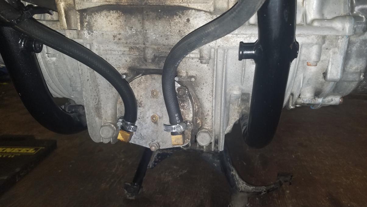

Ok so the 81' 1100e I am going through has a Deraile oil cooler mounted on it. My plan was when I get to that area to make up some better mounting brackets, add steel braded lines, make sure the lines are nowhere near the headers and of course clean up filter cover of the mess that remains after a thorough degreasing of the entire bike.
May I ask if the way its plumbed is correct by the picture? Also is there a gear count known for the 750 oil pump upgrade or another way I can tell if it's been done when I check it out? I live in Alaska and wont be taking the bike to a track...just enjoying it as a comuter. Been wondering if I should just pick up a different cover and nix the cooler idea all together. But then again if its helpful it would look cool all cleaned up with pretty stainless lines on it and I know cool factor makes a bike faster......that's my story any hoo.Attached Files-1981 Suzuki GS1100E

Originally posted by TeamDar View PostYes that looks correct. Gear tooth count is 38-29. I have some for sale.
