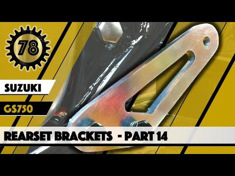

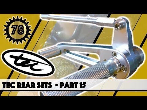

    Watched this guy’s whole series on building a GS 750 cafe racer. Not my thing but nice work with less than professional tools. This is the one where he built the rear sets. But they’re all worth a look.
    and this one

      Thanks, useful info there.
      As I figured, the levers and pushrods are the difficult parts.
