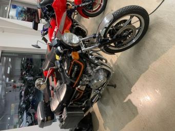

Need tips on how to easily increase the power on a GS 500 from 1981. Where to start?
Gs 500e 1981

is this you on FaceBook? I just happened to come across this on FB after seeing your post here. Nice looking 500.
I can’t do anything with the pic you posted. There is a bit of a trick to posting full size pictures on the forum. Link in my signature if you’re interestedLast edited by Rich82GS750TZ; 01-27-2022, 06:45 PM.Rich

Where did that bike come from? They didn't sell that model in the USA.
Best upgrade is install 650 cylinders/pistons/head. There are lots of threads here on this upgrade path.Ed
Originally posted by Nessism View PostWhere did that bike come from? They didn't sell that model in the USA.
So easy path to 5501983 GS 550 LD

See OPs location. SwedenRich

Originally posted by Rich82GS750TZ View PostSee OPs location. SwedenEd
