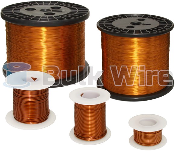

                Here are a couple of links for the stator winding wire:
                Perfect for Winding Coils, Inductors, Transformers, Lighting, Ballasts, Relays & Timers, Motor Applications. Insulated with polyurethane and nylon.
                PlanetEngineers.com - Online Shopping - Choose from a complete line of standard electro-mechanical components and other related Engineering Materials.
                I used 18 gauge, and was able to get about 30 winds per pole, which is what the OEM stator had also.
