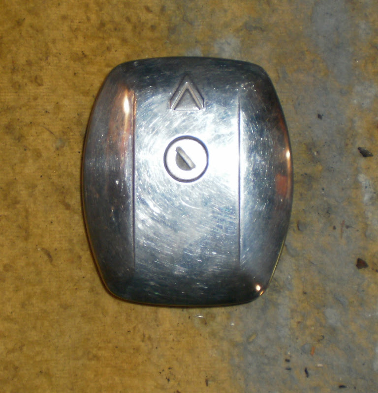

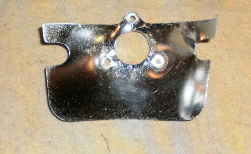

        Stupid lil project #1
        OK my gas cap bugs me , I am gonna be looking at it quite a bit ( hopefully )
        I think a trip to the buffmaster is in order
        Short and sweet
        Before ( dingy )
        After , I can live with that
        ( tripoli compound followed up with Nev R Dull )
        Later

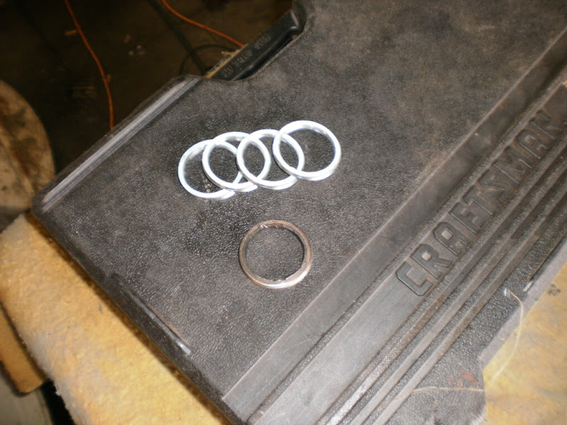

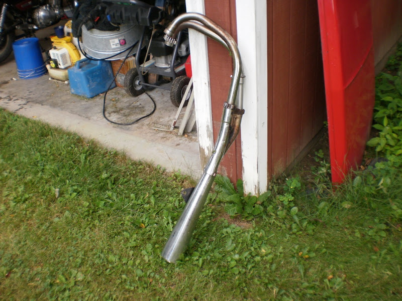

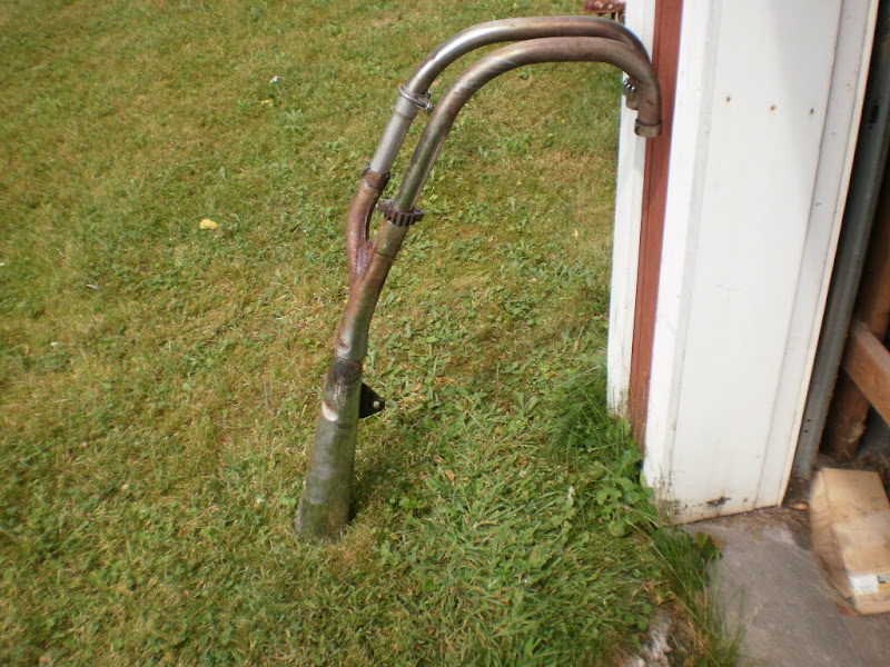

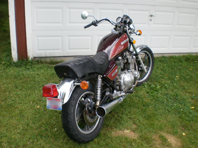

          Exhaust , how I hate ye Part 3
          What you didn't get to see . ( no pics )
          I went ahead and had two pipes made to replace that stamped steel crossover that I am sure you have already seen a hundred pictures of all rusted out .
          My version uses heavy gauge 1.5 inch ID exhaust tubing . the parts store expanded the pipes to slip over the headers . I used automotive muffler clamps on the engine side ( upside down so as to max ground clearance ) .
          stock band clamps to the muffler connections .
          I fired it up and it was almost quiet ( Yay ! ), except for SOMEBODY forgot to order exhaust gaskets ( boo ! ) .
          What you do get to see
          Tearing the exhaust off , yet again , to install the little wonders .
          SIGH
          Probably the best shot of the bypass pipe I have
          ( prior to "cleaning" up the pipe )
          A "cleaned" up shot ( sometime patina wins )
          four little wonders with the one old one that came out intact
          Why you NEED to order these things ( old one is on the left )
          Later
          Rat

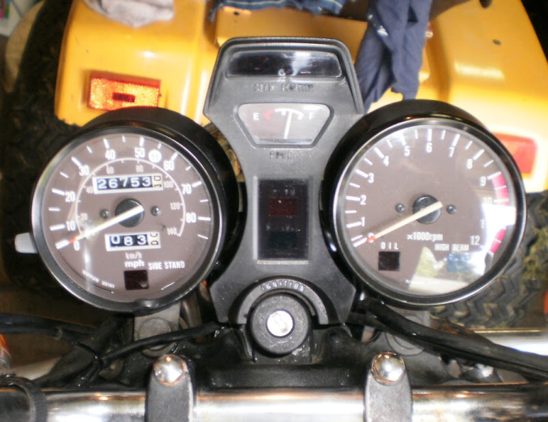

            Stupid lil project #2
            OK my gauges bug me now
            Did you know , you can polish plastic lenses with a rag , a Q tip , and toothpaste ?
            Now you do
            The obligatory before pic
            After ( and minty fresh ! )
            Wasn't that exciting !

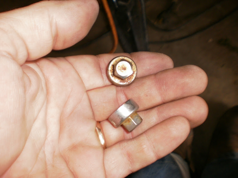

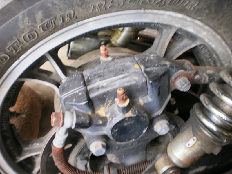

                  #38

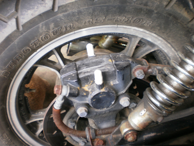

                  Stupid lil project #3
                  Ok the rusty crappy brake bleeders have to go.
                  I am gonna hide em of course , not like I am actually gonna do work on this yet . lol
                  Now ya see em'
                  Now ya don't.
                  Rat

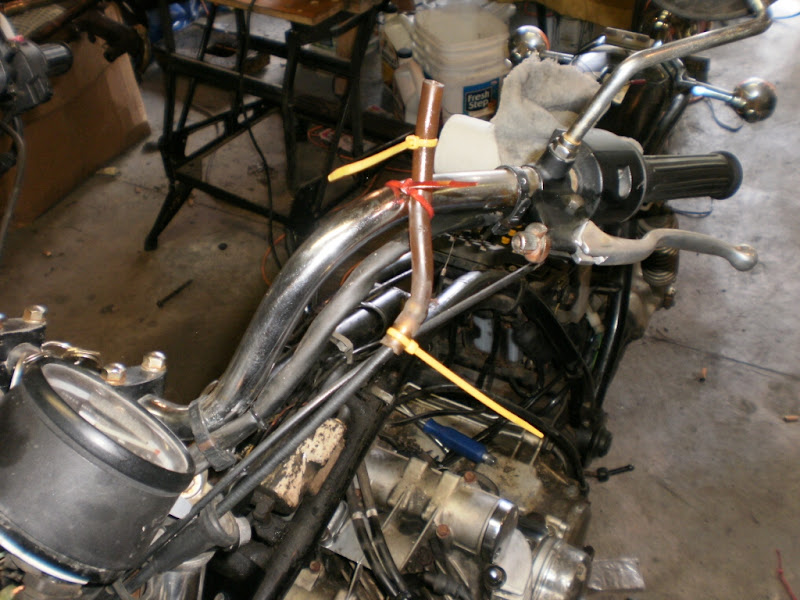

                    #39

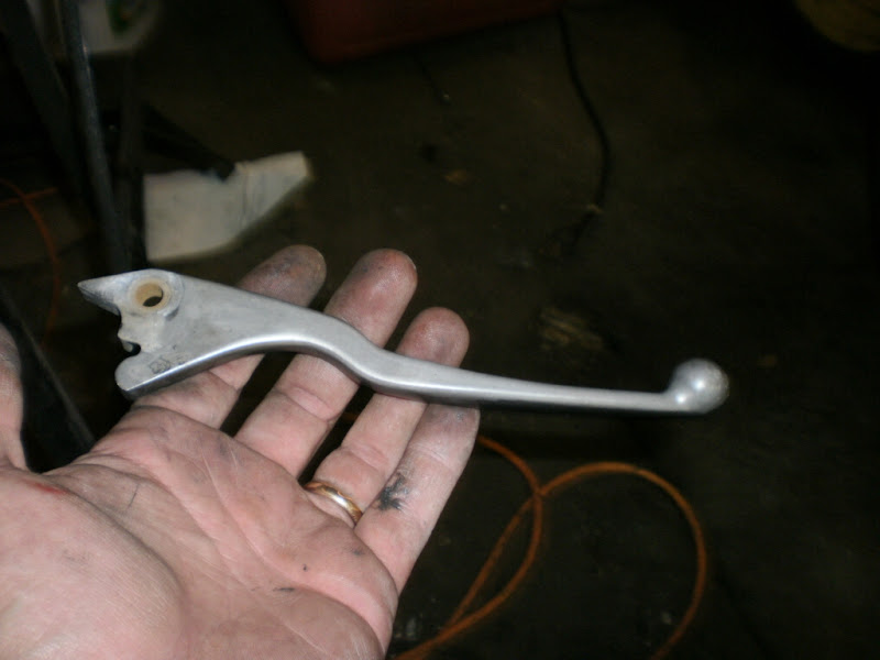

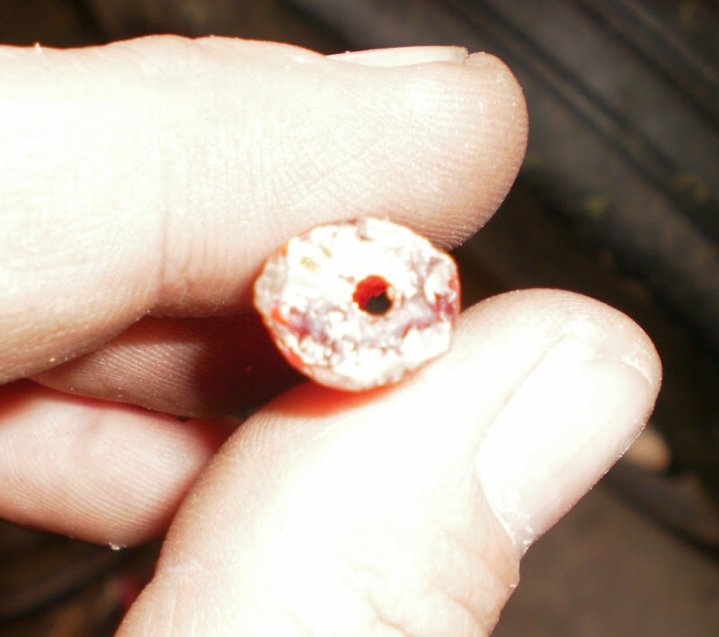

                    Mysteries of the crappy clutch revealed
                    At last , a relatively straight forward repair.
                    I went in search of what was making the clutch action pretty lousy .
                    it was easy to find , a DRY clutch cable , and corrosion at the lever pivots , easy fix, oil the cable and clean and grease the lever pivots .
                    DRY pivot , don't think this thing has seen lube for a while
                    Ok this is a brake lever , but you get the idea
                    the Super Duper Cable Luber ! ( Yep its a chunk of 1/4 inch ID surgical tubing , Gravity is our friend ! )
                    Maybe not the most clear shot , but trust me , its oily !

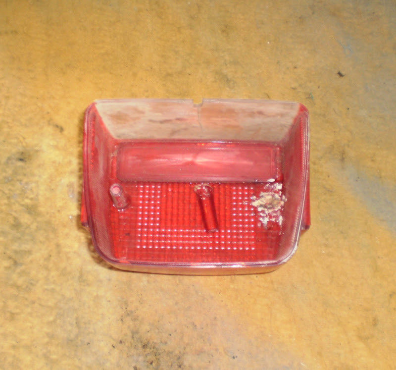

                          The Great Tail Light Post
                          The problem , the tail light looks like poo ( Ya I know the droopy turn signal aint helpin , thats another post ) , and its broken .
                          It lights up just fine , it has a broken mounting post . Which will end up being two broken ones before its through
                          A previous owner tried to glue it already , nope , didn't take .
                          I decided to re-engineer things a little bit .
                          Suzuki built it with the posts molded into the tailight to give you that smooth looking outside .
                          I am gonna screw it from the outside , this gets a little hard to follow but I think you will get the jist of it .
                          Using a small drill bit I put a hole through the broken post , small is key , I don't want to tear up where the factory screw threads in .
                          Again hard to see but i drilled through the lens on both posts( symmetry rocks ! )
                          While I am at it I might as well clean this up , and fix the dent ( how in the world do you dent a reflector ? )
                          Reasonably clean and straightened out
                          OK , I used two chrome plated trim screws from a car for my little mod .
                          the screws are only to reinforce the posts a bit ( plus some ten minute epoxy on the broken one ) .
                          It still attaches to the bike the ORIGINAL way .
                          I also had to shorten the original attaching screws about a half inch per side so they wouldn't run into the screws I just added .
                          Some finished shots ( YES, the buffmaster 1000 does plastic tail lights )
                          The only caveat I can offer if you try this ( I assume its a common problem )
                          28 year old plastic is BRITTLE ! Drill bits have to be SHARP . You must go slowly and carefully or you will crack the lens !
                          Later
                          Rat

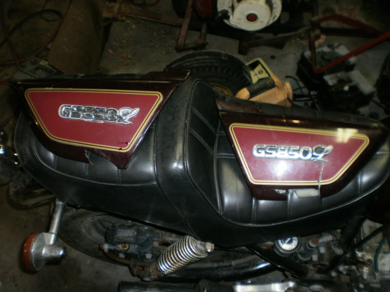

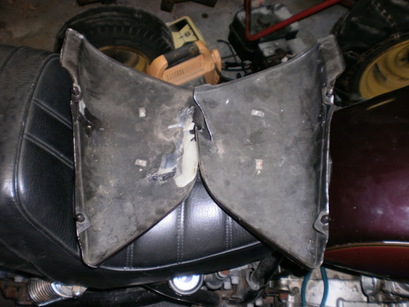

                            #43

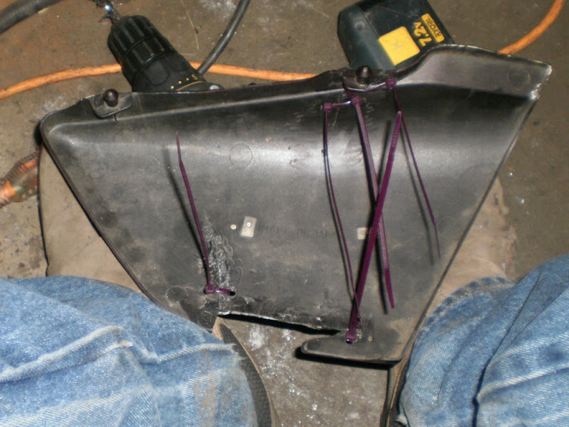

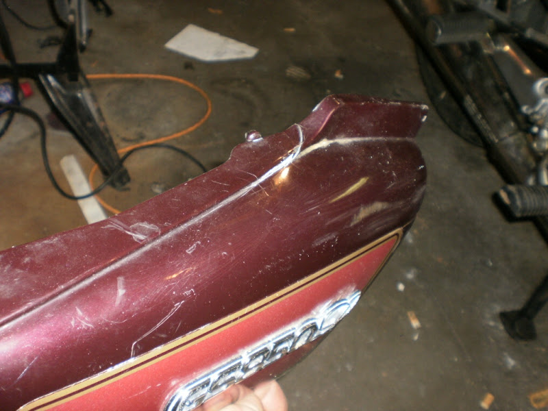

                            The hack job side cover post
                            Well, the side covers on suzy were not in the best of shape , both had multiple crack and both are missing the lower mounting tabs
                            Now I have ( in the past ) built up a inside shell out of fiberglass and done bodywork over the busted sections , but its time to get riding and Suzy looks like crap without these dang things .
                            Putting them on the way they are would be suicide , the crack would keep growing and the covers would probably just blow off the bike after the air catches them enough.
                            Sooooo , I am taking a cue from the atv guys I know , when they crack the plastics on their quads and such , they just drill a couple holes , zip tie it back together , and keep on truckin.
                            So thats what these pics are I zip tied the cracks and add a hole to the bottom of the covers to loop a zip tie to the lower mount on the bike .
                            If you are sensitive to such things , LOOK AWAY ! HACK JOB CONTENT .
                            Original shot of the covers when I got Suzy
                            Backside , under all that hot glue was some mesh , somebody tried .
                            AND a plastic welder repair job under that
                            Cracking at the upper mount
                            This pretty much shows it , extra hole is for lower " mount "
                            Other side is a bit worse ( more plastic welding )
                            Zip ties all over the place
                            Yes I used this pic in another post, No you didn't notice
                            Later
                            Rat

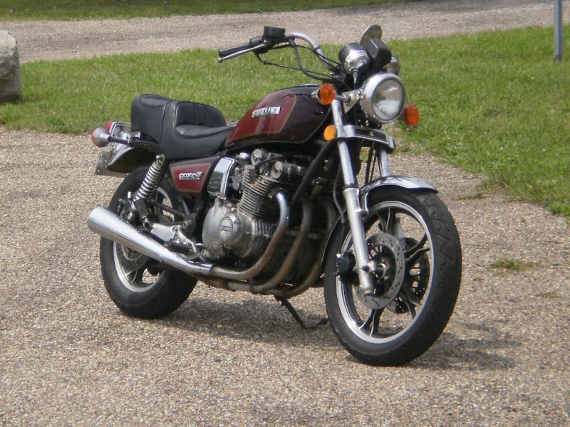

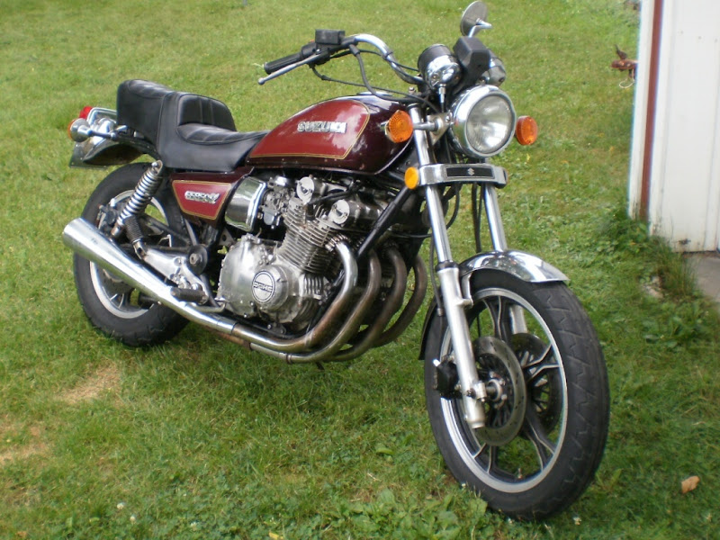

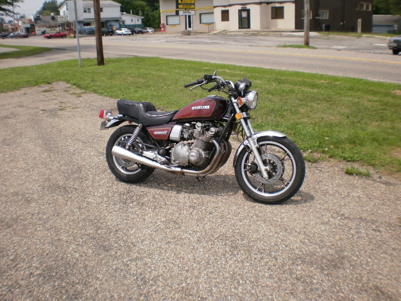

                              #44
                              NO dirty garage floor pics in this post !
                              Cause we aint' in it !
                              Prior to a 70 mile shakedown run
                              Out on the lake ( SEE Suzy is self propelled again ! )
                              Nope , not done yet , but quite a bit closer
                              Later ( gone ridin' )
                              Rat

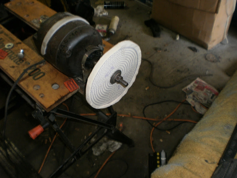

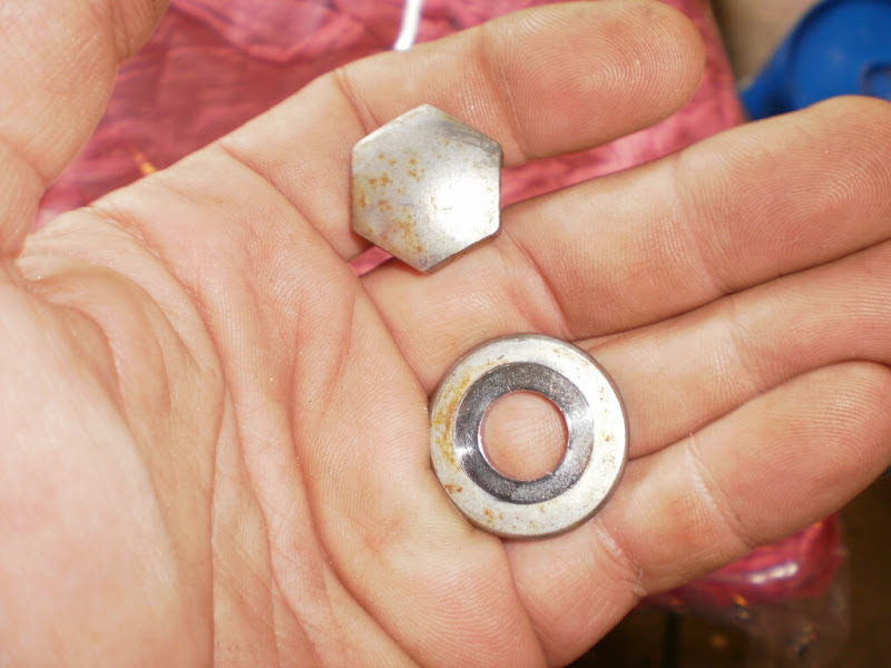

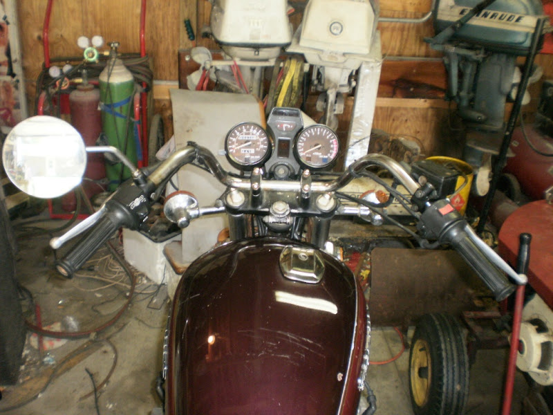

                                The handlebars part 1
                                when last we left Suzy....
                                Yes the splendor , notice that old school single mirror ? Yup looks cool , also leaves a wicked blind spot ( yup I AM getting old ) . the stock handgrips , although a marvel of 82 technology are just too dang small for my hands ( OLD I tell ya ) . Also the handlebars and the chrome hardware have developed a lovely Patina , gonna fix that too .
                                Patina
                                Quick which one of these screws is not to japanese specs ?
                                Answer: the one that didn't self destruct on removal
                                Yup , that should do it
                                Enter the Buffmaster ( new wheel , woot ! )
                                Some rat rodder , somewhere is screaming NOOOOOOOO about now
