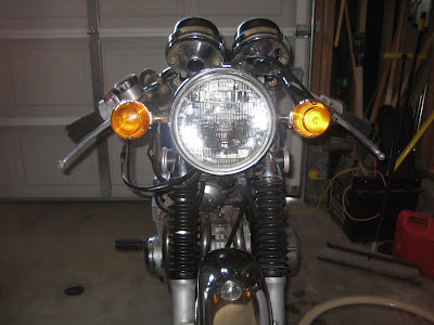

                              Well finally a bright spot on this bike..
                              unlike my other project bike the electrical is completely unmolested..
                              I put power to it last night.. headlight works, gauge lights, tail light running light, starter and so on.. Horn, Turn signals and brake light all not functional but that should be an easy fix.. They all share the orange/green power wire from the fuse box so it's a likely place to start looking..
