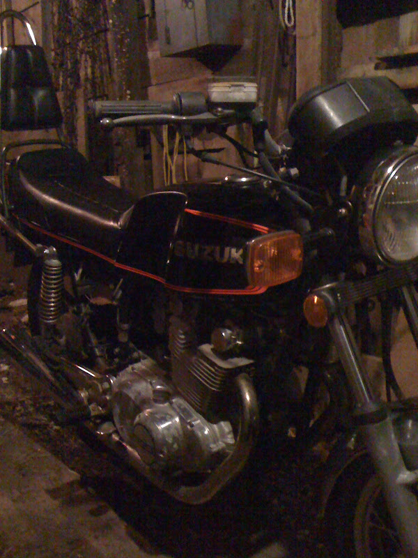

    Pictures are coming! I'm learning about my Picasa service. I'm going out to work on the bike on Saturday, so I'll take some better pictures.

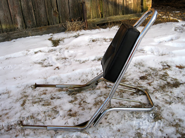

    Here's a picture from the night I bought it. As you can see the seat is in excellent condition. There is no fairing but there is a "sissy bar". These are relevant because the last two characters on the id tag are scratched off and I suppose that could mean it's an ST instead of an ET. I plan on removing the sissy bar and selling it to fund the project. It's in great condition.

        Welcome Aubrey, that actually looks to be in reasonable condition going by that one photo.
        Good to see another twin coming back to life hopefully.

          Why do I get the feeling that your bike is an 'S' model? Did 'E' models come in the black and red/orange colors?

            Yeah, the condition was surprising to me. There is some surface rust but except for the side covers and the battery it's very complete. All the switches and guages are excellent. The seat especially looks brand new.

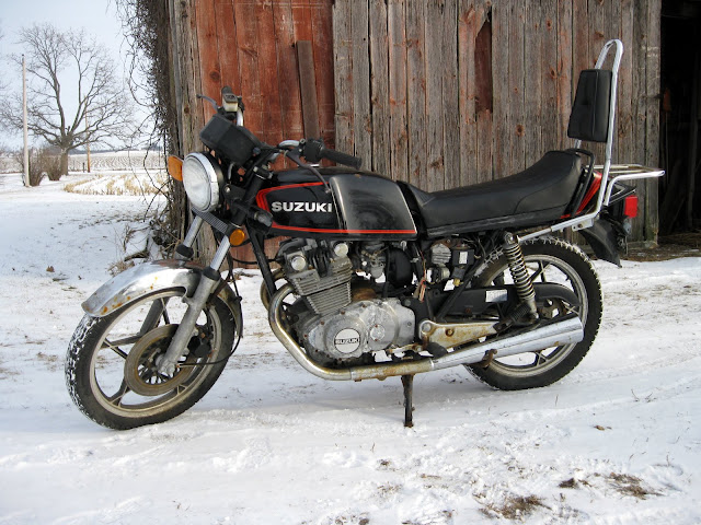

                I got my photo setup working ("thanks honey"). Here are the pictures from the night I bought it. More coming later today.

                  Here is a picture of a 80 450S.You have an E,just so you know.

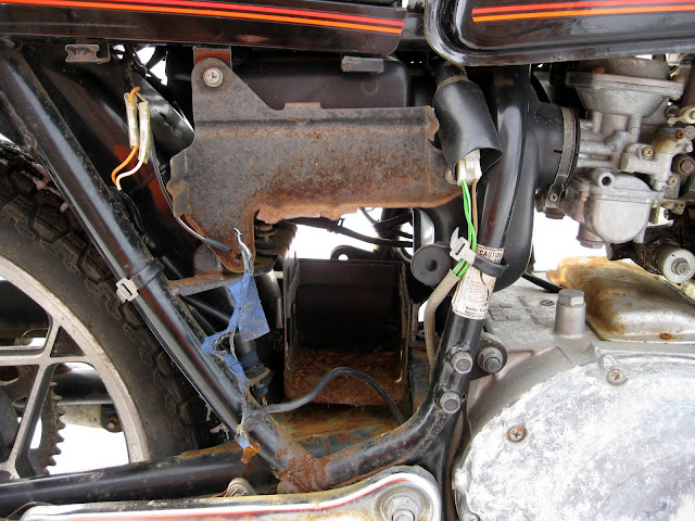

                    The wiring looks a little fried. I wonder what I'll find when I dig into it.
                    Done for the day! Tank off, key code found, carbs off and coming home for a rebuild with Mr. Robert Barr's o-rings.
                    Quick question #1: why are my chokes on the side? I thought they were supposed to be on a cable.
                    Quick question #2: The sissy bar is not my style. I'd like to sell it. What is it worth? Which brackets will I need if I want to add a separate luggage rack?

                      That looks exactly like mine except for the fairing. Maybe that got lost along the way. On the other hand, I don't have the bar-end mirrors so maybe it is an E. Doesn't sound like there are many differences between an E and S. See photos in the post above.
                        Faring,gold wheels,bar ends and body color front fender instead of chrome.Nothing wrong with an E,I bought one new.

                          I am with you on the sissy bar, not for me either, looks much better without it.

                            Definitely an E, just like mine except mine's an '81.
                            The choke on the 450's is on the side, nothing wrong with yours, that's where it's supposed to be.

                              I was thinking it was a stripped down "S" because of the colors. Didn't know the "E" came in that color.
                              But yes, yours is an "E" with the chrome front fender and the black rims where as an "S" would have had gold rims and a matching fender. Not to mention the fairing and the bar end mirrors.
                              Now if I were you, I'd take down that backrest ASAP!
                              EDIT:
                              Wow! I totally missed the previous posts! You already took down the backrest and people have already mentioned the differences between the "E" and the "S models.
