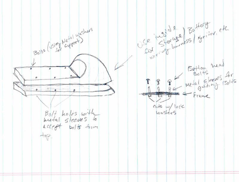

                    I am thinking that is the way to go as well, maybe put the trap door on the bottom of it I can remove a couple of bolts and have the top cover come off completely and still have a fiberglass seat pan, Kind of hard to explain ill draw a visualization in a bit.
                    • gjohnson
                      Here's a quick sketch of what I have planned, any feedback on my idea would be great. the bottom panel will slide into the top cover and then be held in place by 6 bolts with metal guiding sleeves, I plan on using washers inside of the fiber glass to reinforce it. I just don't know if the seat will be strong enough? Under the seat section I might have to build some supports.
                      Don't mind my chicken scratch lol.
                      • Hoosier Daddy
                        So what is your reasoning for "wrapping the entire piece of foam in fiberglass to make it all one solid piece." ? Seems like a lot of unnessecary work to me, but you may have something in mind.
                        • gjohnson
                          I was thinking of different ways to do it. If the entire piece of foam was wrapped it would have a hard time flexing/cracking, but I couldn't move the battery into the rear bump.

                              Guess I'm just a little late to chime in! Did a battery box and seat pan out of fiberglass on my triumph. Foil tape for the base of the pan was worth the extra cost, much easier to work with than kitchen foil, especially on the vertical sections and what not. Something you could still do if you want: For anchor points, I glassed in t-nuts. Just gotta leave a bolt in when you do it to keep the threads clear. Might work well for your cocktail napkin sketch 2-piece idea. My seat build: http://www.youtube.com/watch?v=Q14K_sny5YQ
