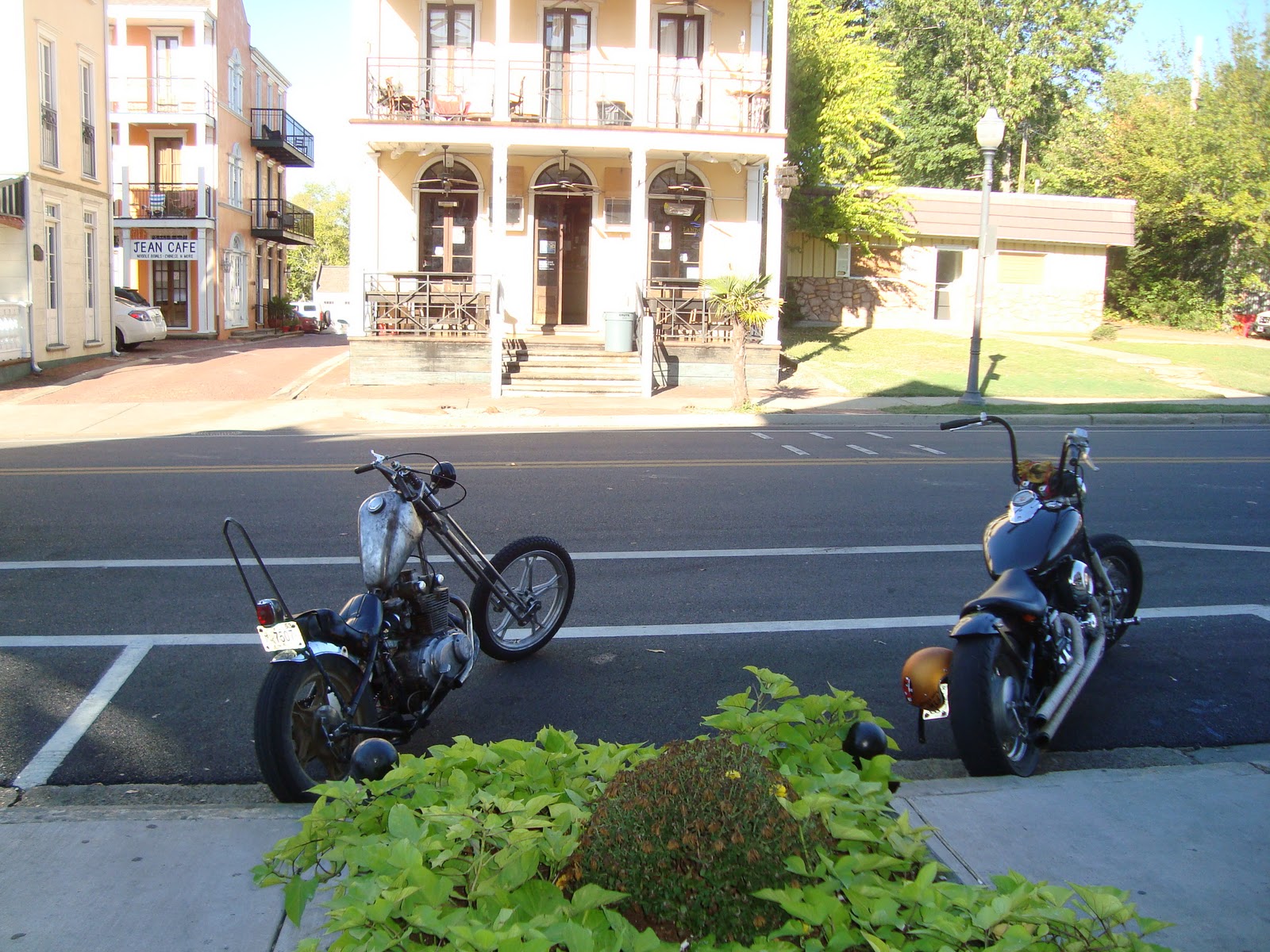

Good stuff! Nice building across the street there too...
Forgot to ask if you're planning on putting the front brake back on or are you happy with just the rear drum?1982 GS450E - The Wee Beastie
mlc216
I'm not going to put a disc on up front, but if I switch to spoked wheels anytime soon I'll probably try to build a brake stop bracket on the springer... but for now the rear brake stops me just fine. I just ride a little differently when I don't have a front brake...
Cool, just curious... it only just dawned on me in that pic that it was missing...1982 GS450E - The Wee Beastie
mlc216
Aaaah yeah der... forgot about that! (Just picture me slapping myself in the forehead, no smiley for that!)1982 GS450E - The Wee Beastie
