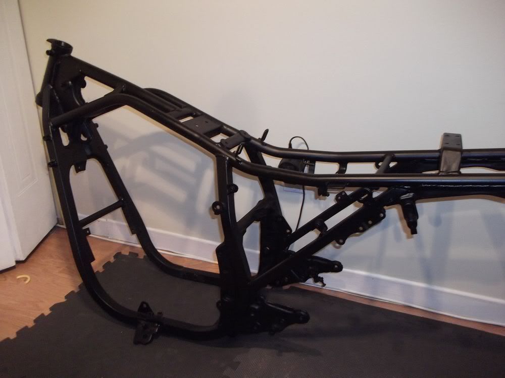

    then i cleaned up the garage for almost 2 hours! X)
    and that s it for this week end fellas!
      Nice work, that frame is looking real good
      And yes, a garage clean always helps
      1982 GS450E - The Wee Beastie
        Nice work on the frame, looks brand new, keep it up.
          @Pete and Flyboy.
          Thank you guys!
            Nothing like as fresh painted frame
              Great stuff, That frame turned out sweet! I'm a sucker for progress pics so keep 'em coming!
                You're making really good progress Etcheberri,the frame looks great!

                  next week end i plan to
                  Clean the inside of my tank.
                  (After much hesitation i ll give my tank/panels to a guy that has a lot of experience in painting these, he offered me a realy good price for the whole lot,
                  would cost me more to just buy a compressor+gun...And i want the best finish possible, i won t give that bike that said finish, not as good as that man will.)
                  pull out wheel bearings, clean/paint the wheels.
                  (can i work on them without having to remove the tires? :P)
                  and probably Clean/sand/paint as much pieces as possible.
                  What s next on my buy list :
                  Flywheel puller, rotor holder, valve seals, with these 3 items i ll have everything to finish the engine block.
                  then i ll need some way to mount it on a stand (going to use a car engine stand with some stuff to give it space, i plan to paint it on there, cure it with a heat gun. (i asked a dupli-color specialist for that, even if anyway the engine will cure the paint with it s own heat, just need to run slowy 2-3 sessions of 10-15 minutes, but i want to be sure! )
                  (no domestic oven environnement allowed for me :P)
                  and, because i am a geek, i think i ll build up a basic electrical system (with a car battery) to bench-test the engine, before putting it back in the frame...
                  maybe i ll even rig it with the speedometer and clutch/throttle. but that s not for sure at all.

                        Very nice job on the frame, I forgot how much crap I cut off when I powdercoated mine.
                          Good call DP, that was a brilliant idea of Daniel's.
