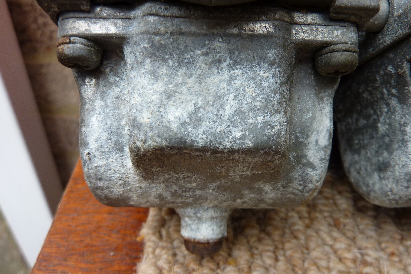

                        Regarding you stuff about cleaners; thanks for that but I really am going to need somink that we take off the corossion as well. This is what I am up against:
                        Have you any experience of ultra-sonic cleaning systems and where I might find someone to do it?

                          OK... OK... THAT is the worst looking bowl that I have EVER seen.
                            So . . . . new bowls then? Nah. I reckon they will come good!
                                Greetings from Canterbury.
                                Hi londonboards, I think you'll need a combination of cleaners and elbow grease for those bowls!
                                In terms of ultra-sonic stuff I've seen a few kits around for a reasonable price (machine mart etc.) but no personal experience.
                                For rust electrolysis is a good way of effortlessly removing large amounts of rust from metal - you just need a battery charger, a few bits of metal and wire and a container big enough to dip whatever you're cleaning. You could even use this method on the frame!
