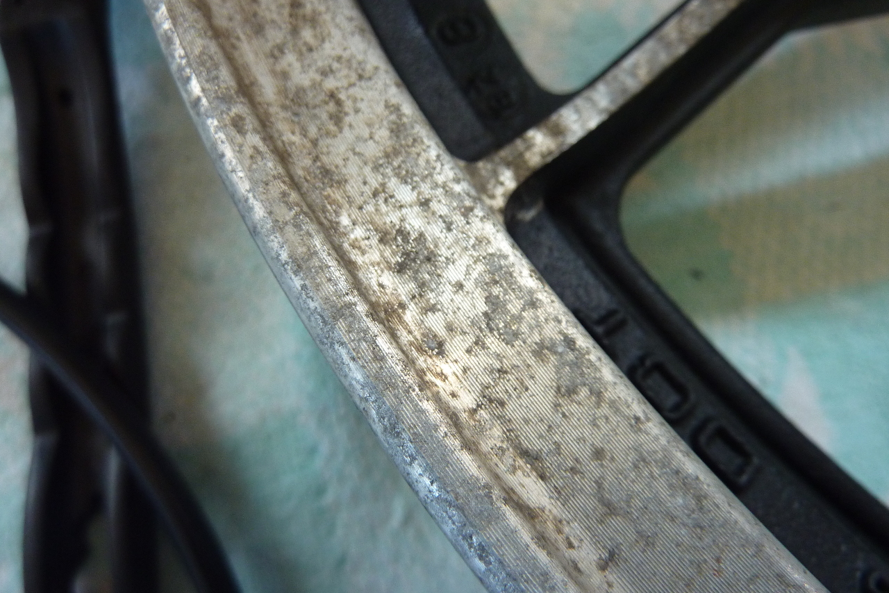

                  This is what the wheels looked like to start with:

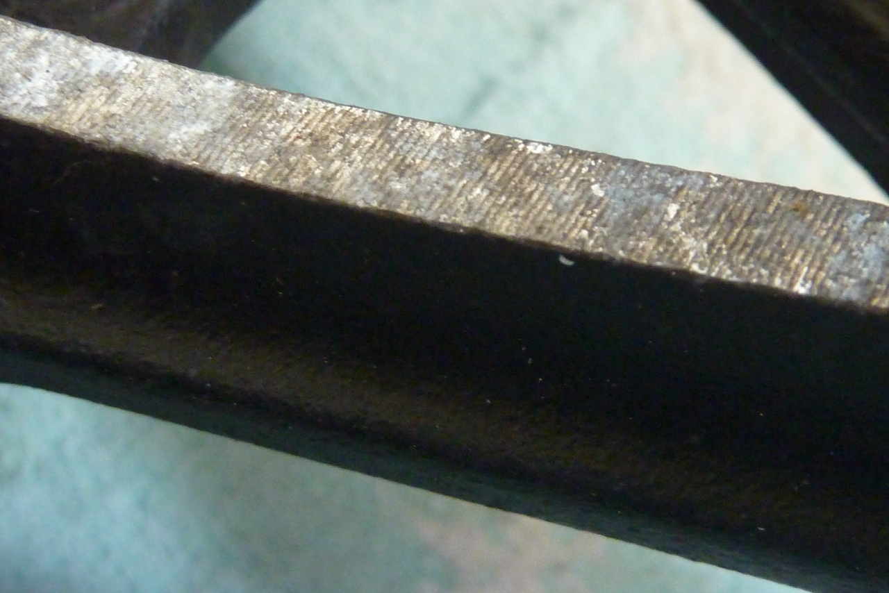

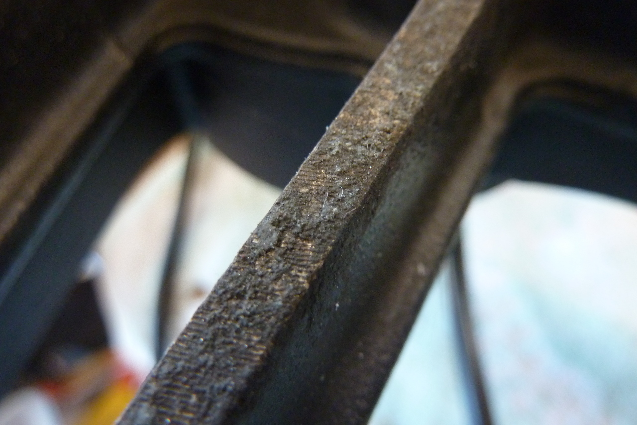

                  They are in a pretty bad way. I started off using 400 grit and got them to this state:
                  They are still pretty mottled and needed a lot more polishing. I tried all types of polish and ended up using Brasso on the back of a Scotchbrite pad. I ended up with this:

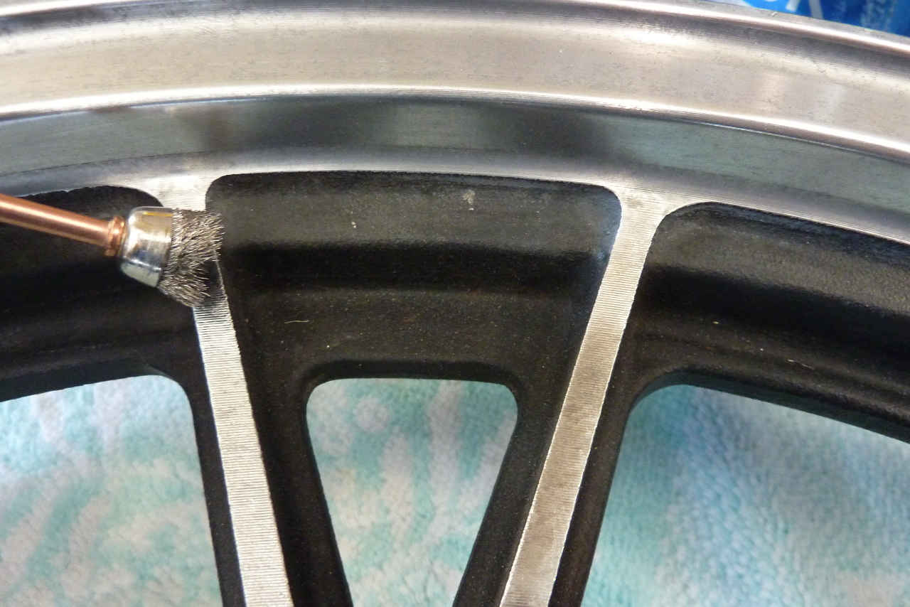

                  I also spent some time on the spokes with a Dremel and a wire brush attachment and went from this:

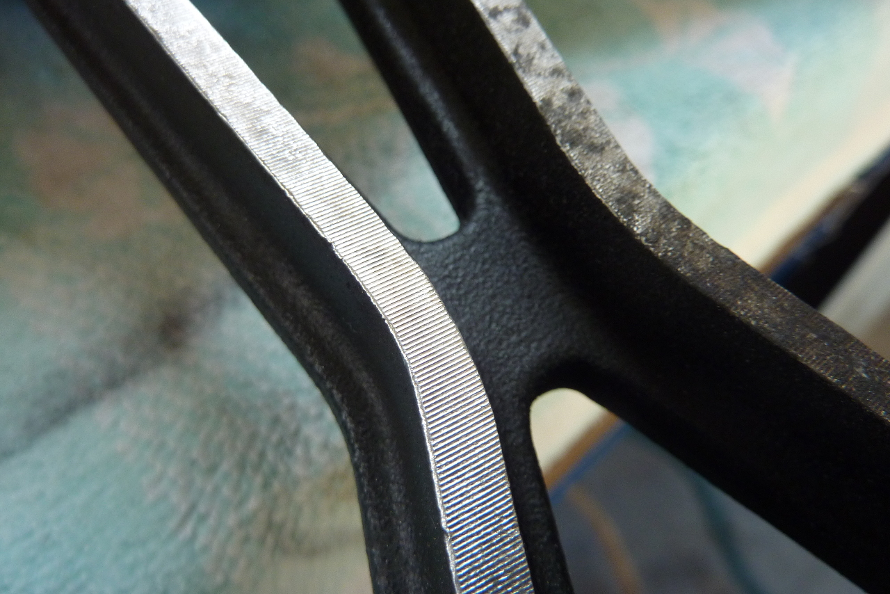

                  To this:
                  One side of one wheel takes about 3 hours. So 9 more hours on the wheels!

                          If you really want to get a shine on those wheels, don't mess about with 400 grit - start with 80 grit, take off all the rough surfaces, then work down through the stages to say 800/1000, then use your favourite polish.
                          You could use a palm sander on the flat surfaces to save some arm-ache.
                          Also, the painted areas were originally a dark grey, rather than black, but that of course is your choice.

                              steve - thanks for that. Yes I had heard that the colour was dark grey and even though they are 30 years old now, they still look dark grey. I will get some dark grey enamel paint and hand paint over it. Then when it's all polished up I will try a satin clear coat over the whole lot.
