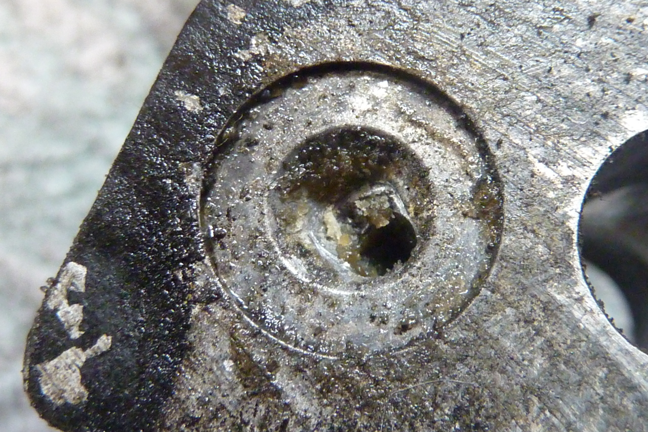

          The bolts and the bleed nipple were stuck fast. More concoction: 50% thinners with 50% brake fluid. That did it.

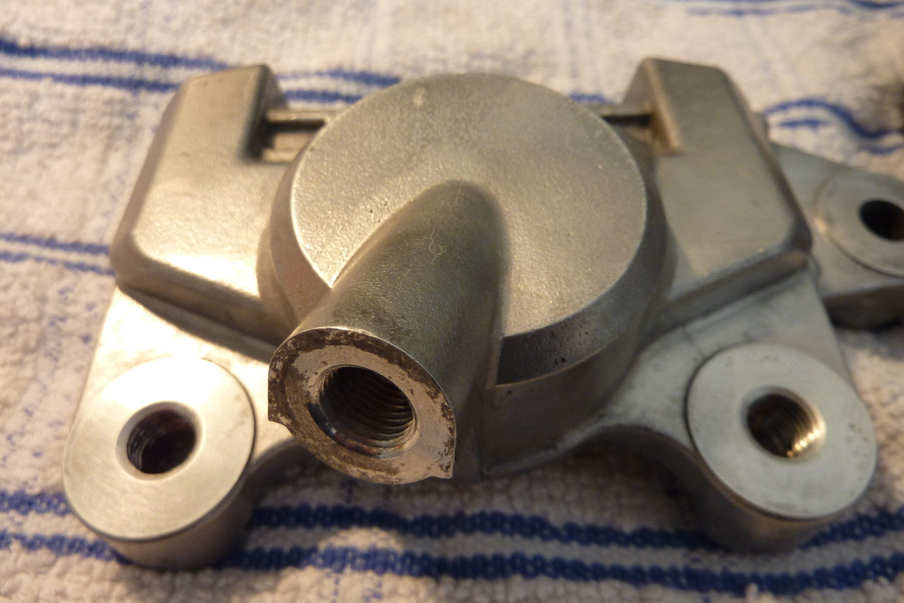

          Got the pistons out with the air pump method.
          Looks worse than it is really. They will clean up good.
          Transfer passages were full of grease for some reason.

            thats not grease Richard, that is congealed brake fluid.
            all of that will clean up lovely, apart from a coat of paint needed.....

              Agemax - I bought some brake cleaner so it should all come good. I was surprised that the pistons in the rear caliper were not all rusted like the ones in the fronts:

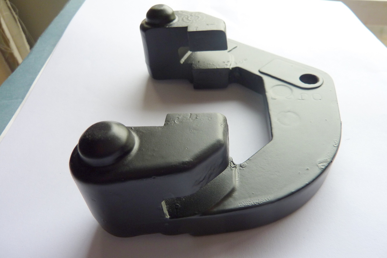

              I've had another go with the VHT painting. And this time I cooked it longer and it turned out a little more satin which is what I want. It's still got some not so nice bits in it but there was no bubbling this time. I think from now on I will try it with none of the white primer undercoat. I can take the frame and all the other powder coating bits down to the powder coaters and show them this brake bit and tell them to match the frame to it. Then the bike will all be co-ordinated to the same finish. Bingo.

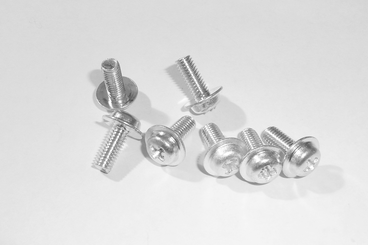

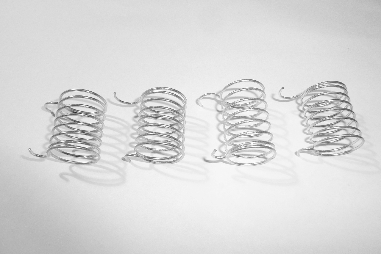

                                I got all my carb parts back from the plater today so I need to get going on the carb rebuild (along with 100 other jobs!). Here are some before and after shots of the cadmium plating done on the parts. I like it a lot. Not too shiny.
                                See: My GS1100 Blog - Carb Parts Plated (nice before and after pics)
                                I bought some stainless screws but I'm not going to use them now.
