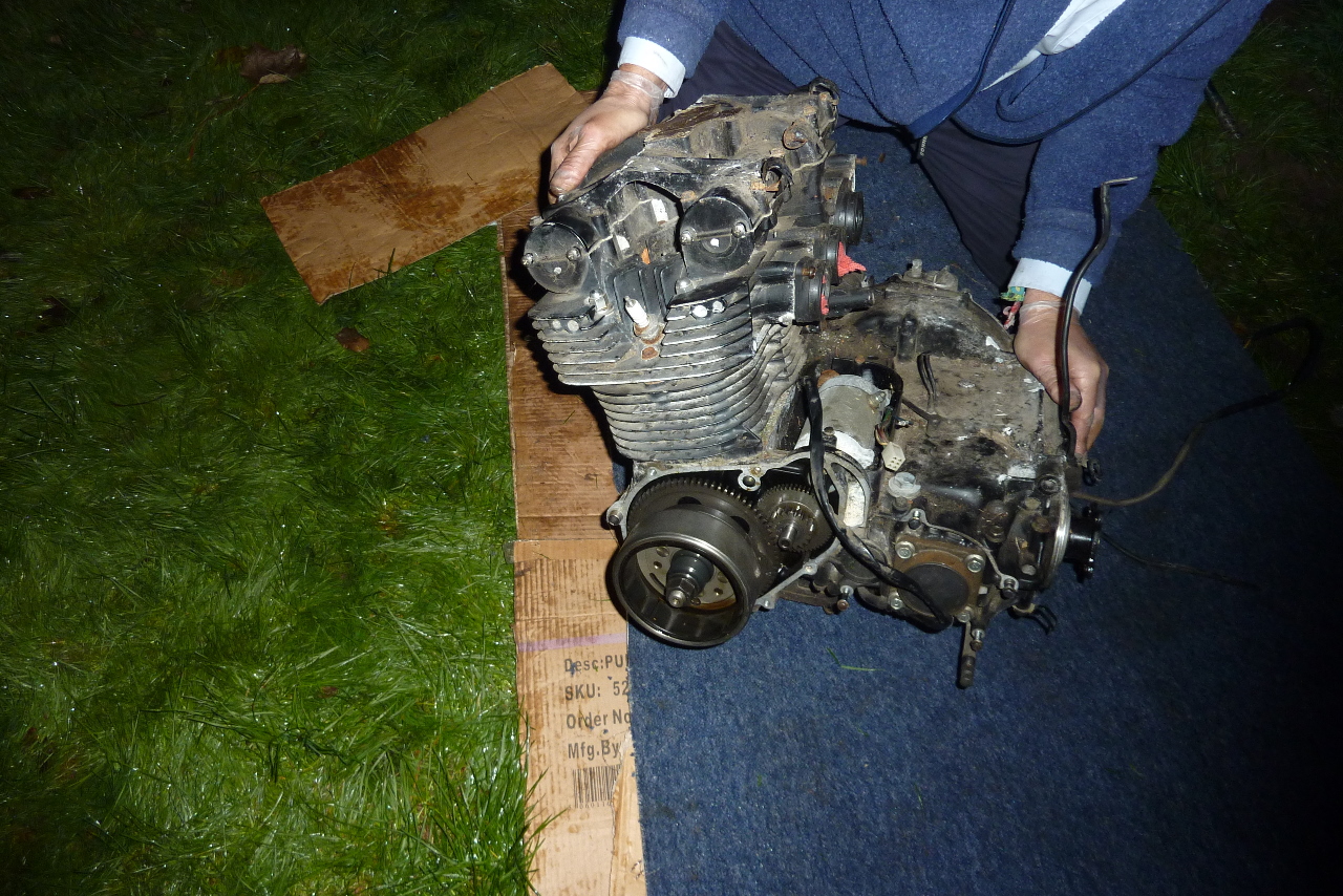

                                Day 85 Engine Removal part 2
                                Here is some more technical (ha ha) information about the engine removal process.
                                See my blog here: GS1100 Blog.
                                First of all you follow the manual:
                                That should be easy enough. It was written by Suzuki so they must have tried it themselves? We laid ours down on the grass:
                                Then nearly 2 hours later if came out:
                                And that is about as technical as it gets. Now the fun really begins.
                                Here's the video again: How not to remove an engine.
                                (Added 17/12/2012) I have just found a video that shows how it should really be done: How to remove an engine properly.
