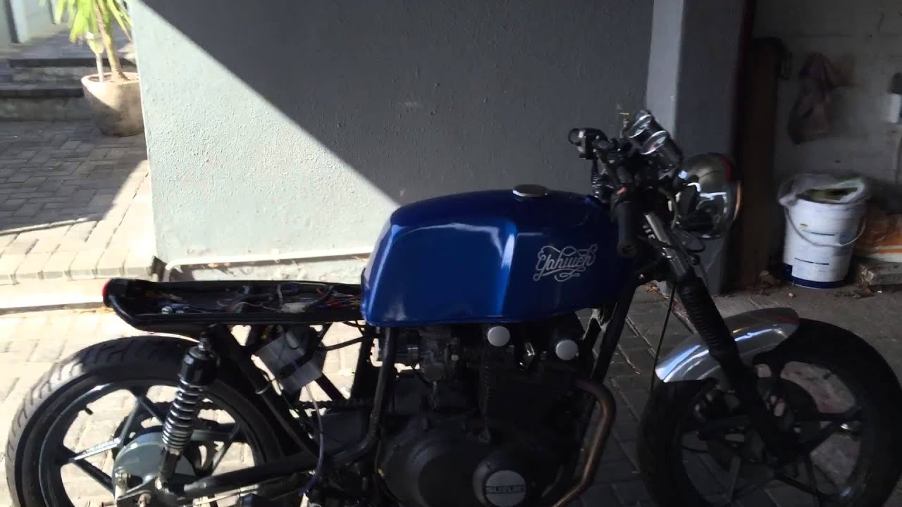

Huge day for me today!
Yahweh tribute bike is eventually running on her own steam!
Electrical issue turned out not to be much of an issue. Bought third set of carbs, cleaned and fitted them.
no more fuel leaks!
Got air leak somewhere on carbs causing hanging idle, needs carb adjustments, clutch adjustments and front brake is pulsating, but she runs!!!
Success!!!

After 2 years, that's gotta feel great, Wally. Way to stay with it and get it running. Does sound like it needs a bit more fiddling, but overall, nicely done. My favorite part of your bike is the tail light and how you fitted the seat back around it.1979 GS1000S,
wally
Thanx! The fact that we moved house and work scenario changed helped a bit!
i definitely didn't want the taillight to look like a simple bolt on.
Can't wait to get the seat on!
Hopefully Monday!
