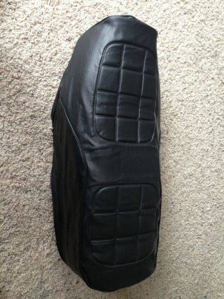

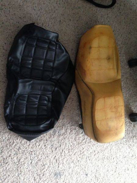

                      Finally received my seat cover from Thailand and got it put on. Also put on a new throttle cable. I took the carbs off to check the jets and see if it was rejetted, I can't figure out why it won't run nice with the baffles in the exhaust.
                        #41
                        Much better than the torn up one that was on there!
