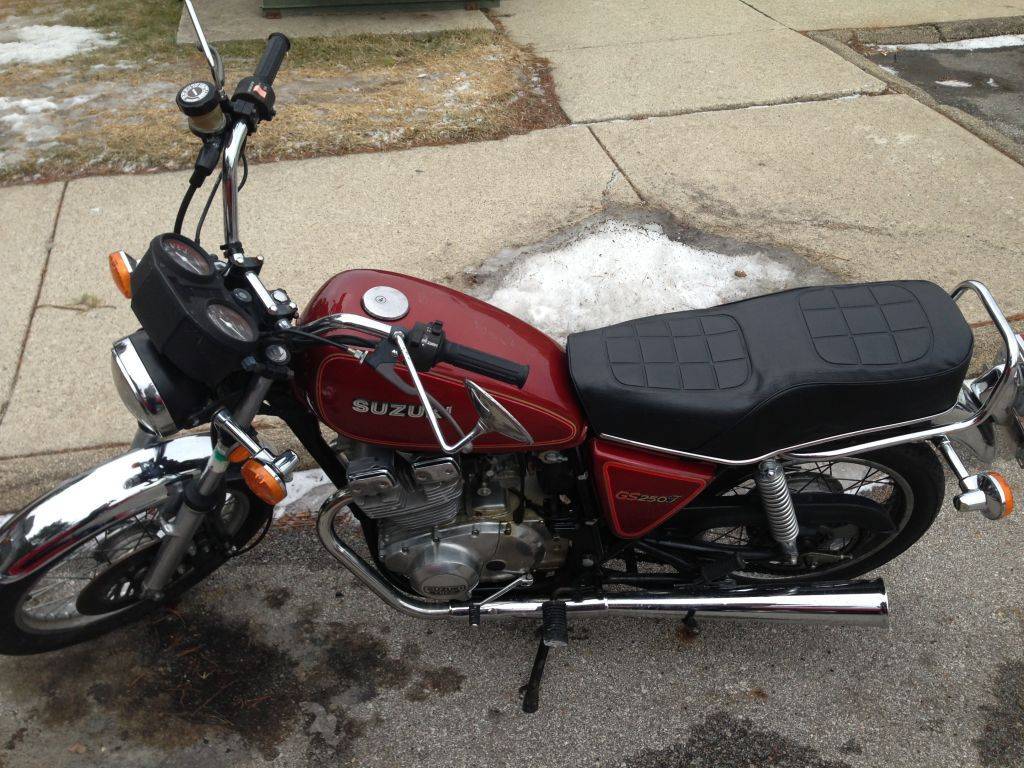

Rebuilding my 1980 GS250T here...
Excellent! Could just be condensors on the coils have died too, not sure if they're replaceable though... and of course the typical points gap/filing etc...1982 GS450E - The Wee Beastie

Good call. I think I will order new points and condensers first. That would save about $90.
I'm going to start a new thread for this bike. Should be another fun project. I don't think I will need to get into the engine on this one though. Carb kit, ignition kit, seat cover, and headlight is what I plan on right away.

Very doubtful that it would be coils, they seldom conk out in my experience. More likely the ignitor if its electronic or points and condensors otherwise. If it is points try cleaning them with a bit of sandpaper or a points file first before spending money. It could also be the plug caps as they sometimes get too resistant. I've encountered that on 2 bikes now. Plug caps are only around $7 each so worth looking at too.It doesn't run because it doesn't have spark so the first thing I'm going to replace are the coils I think
Looks like a sweet little bike. Well done.

Good call Spyug. Before I investigated much, I assumed the plug caps and condensers were part of the coils. I see I can get everything separate now so I won't replace the coils unless all else fails. I can get new condensers and points for $18 so I'm going for it. I really hate dealing with points so I'll start fresh and then I know they're good.

I'm a little late to the thread, but I just wanted to comment: wow, that's a pretty good result on that chrome! My whole bike is pitted like that, maybe a bit worse. I wasn't going to do anything about it but after seeing your pics, maybe I'll give that Noxon 7 a shot. Does anyone recommend any other products as well? How about something to protect it, regular auto wax?

I thought the chrome came out great. Noxon is one of the best I've used. A little elbow grease and chrome comes out great. I used to detail cars and bikes so I figured out what works pretty quick. Any good wax will work for protection, just don't get a strong cleaner wax. You don't need the cleaner part and it could dull the chrome. I use synthetic sealer wax because it lasts a lot longer than carnauba wax.

Sweet bike! I just bought a 1980 gs250 my self and I am in the process of getting it back into shape. Yours seems to be in a lot better shape than mine at the moment haha but just a little at a time I guess.

They are fun little bikes. The 6 speed makes it seem faster than expected. I didn't see a current picture in my thread since I did all the work so enjoy. The tank paint isn't as nice up close but it will do. I waxed it heavily for protection.
