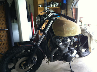

    Head over here to check the pics of the rebuild. Follow the blog by clicking on the follow icon and you'll get updates as they happen.
    The restoration of a 1981 Suzuki Gs 850....possibly to a Street Tracker style
    Almost on the road. Just a few things to tidy up.
    Will post a youtube clip when she fires up...its a sight and sound to hear!

    I'm a bit of a scrambler fan myself but I do appreciate a well done tracker as well. I like the dual sport tyres

      Those tyres are of a BMW GS (Heidenau) flamin expesive but look the part and should be very grippy !
      Its almost done and should on the road in a month ready for the shows.

        I looked into those tyres for my scrambler inspired 450 but like most dual sports they don't have an 18" front and rear. I ended up with a Pirelli Scorpion Trail front and Scorpion MT90A/T rear as that's the only combination I could get both 18" in. They seem to work pretty well together on the tar, but I'm not game enough to scratch the paint work and ceramic pipes by taking it on any gravel...

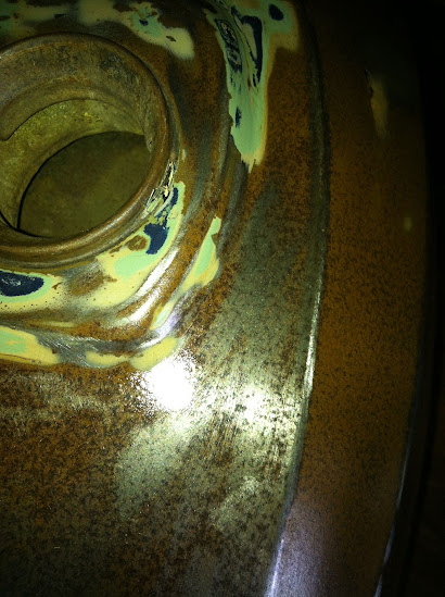

              Ive done a rust look on the tank with chemical treatment ...unfortunately it looks way better in real life...the pictures dont capture it well
