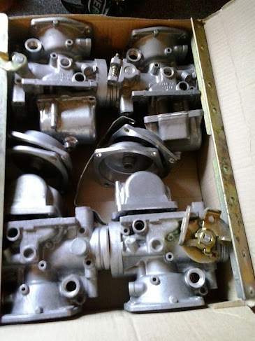

Air box and carbs off both the air box boots and carb boots are very hard so they will be renewed along with all the rubber tubing. 2 of the carb boots still need to come off but I need some propane to get them off
