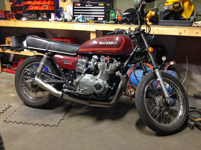

                    Well this is where I am at, well sort of. I have done a few things since these photos like buttoned up the tailpiece and rear lights. I am abandoning the race paint idea. I kinda fell in love with the stock paint with chrome and black... I think it looks good with the natural pipe wrap as well. Needs a seat and a few things but I have been out on a skateboard seat pan (east van seat pan) and a piece of foam a few times and really enjoy the new feel and positioning. A little more aggressive and in control, more like riding a motorcycle less like driving a bus.
                    I've done the charging system upgrade and dyna ignition upgrade. Valve clearances are done, carb is rebuilt (need to do the float needles still, they are sitting on the bench). Still not happy with the compression but it's running enough to have a little fun this summer while I get my other bike(s) on the road. If she get through the summer ok I will dig a little deeper with a leak down test... in the fall. But I am pretty sure the PO started something and retreated. I also got called in on clerical mistake with the vin number because it started CS750 not GS750 on the registration. They just changed it for me. I was going to ask if it was a U build... and thought I might not want them to dig much deeper incase something was waiting to bite me in the ass.
                    Do I need to pull the engine out of the frame to do the top end on these bikes?
                    I will trade my complete box of OEM parts for a complete top end if anybody close by is into it. I think it might be nice to have one on hand. I'm not really into packaging/shipping but could consider it.
