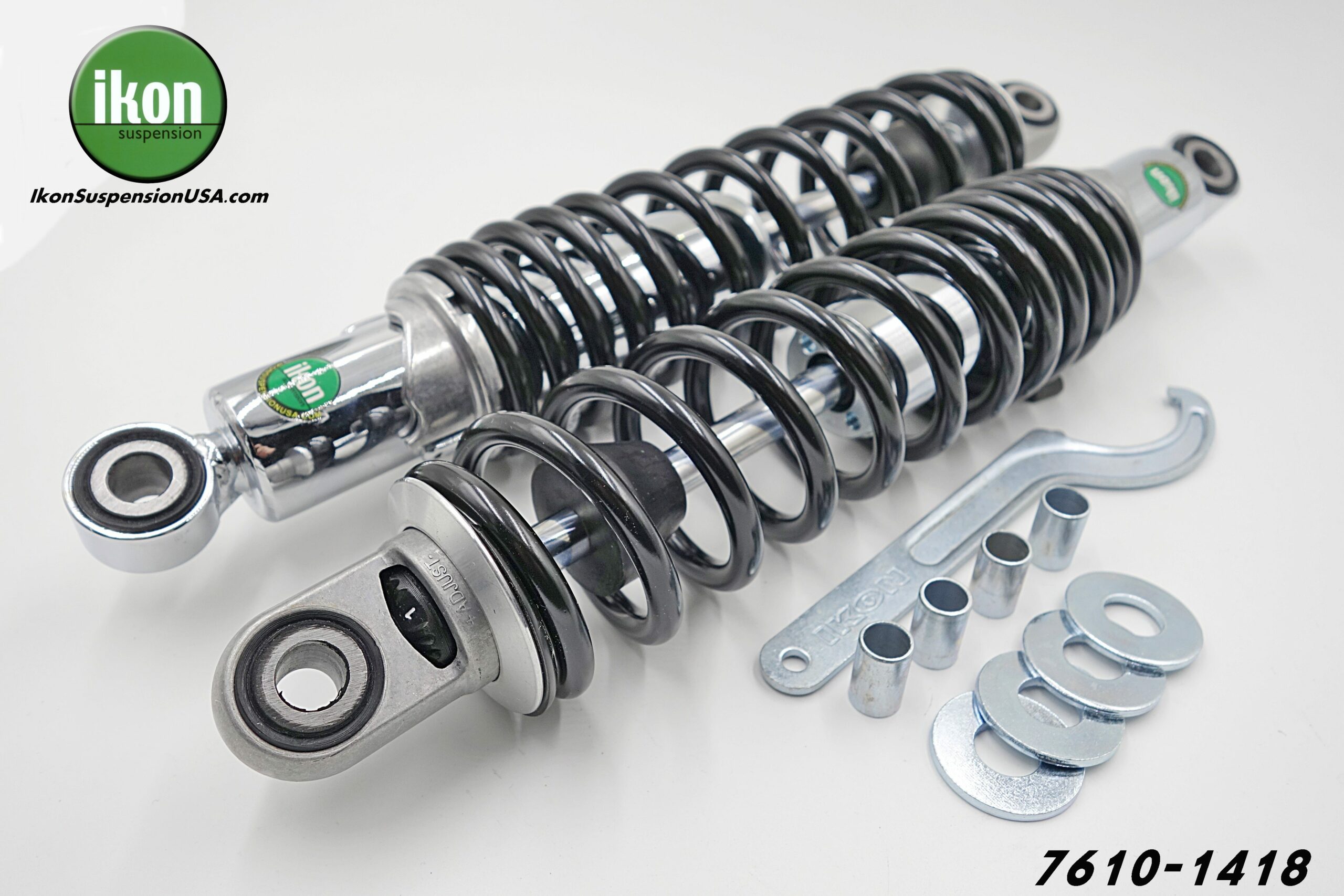

                Would you care to share what kind of rear shocks those are?
                  They are RFY shocks. I found them on Amazon for $100 and they got decent reviews so I figured I would give them a try. but they are too short and also seem cheap. After doing a bit more research into them (post-purchase) I discovered that the internal parts are cheap and they tend to fail and degrade quickly. so I am going to buy different ones before spring. Haven't decided yet, but they will be the same style of shocks
                    Roger that.
                    I was considering Hagons or Ikons (in case you wanted to look some more). What's the purpose of that remote reservoir?
                    I think these are the Ikons that would fit your bike:
                      This was the site that I referred to when choosing a shock. From what I understand, the resevoir keeps some of the oil seperate from the piston keeping it cooler which in turn prolongs shock life and also allows for more aggressive riding (far beyond what i will do). I'm pretty sure it has some other benefits as well but i think those are the main ones.
                        Nice resource! I'll look more into it when I get home, thanks!
