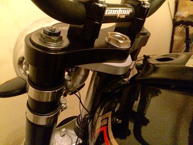

                              Did a final dry fit of everything before I paint the frame. Lots of pictures coming up.
                              Steering Stop bolted on to the upper triple tree
                              This one is looking up. You can see the tab that was already on the frame that I'm using as the positive stop
                              From the front with the bars turned all the way
                              Looking up with the bars almost at full lock
