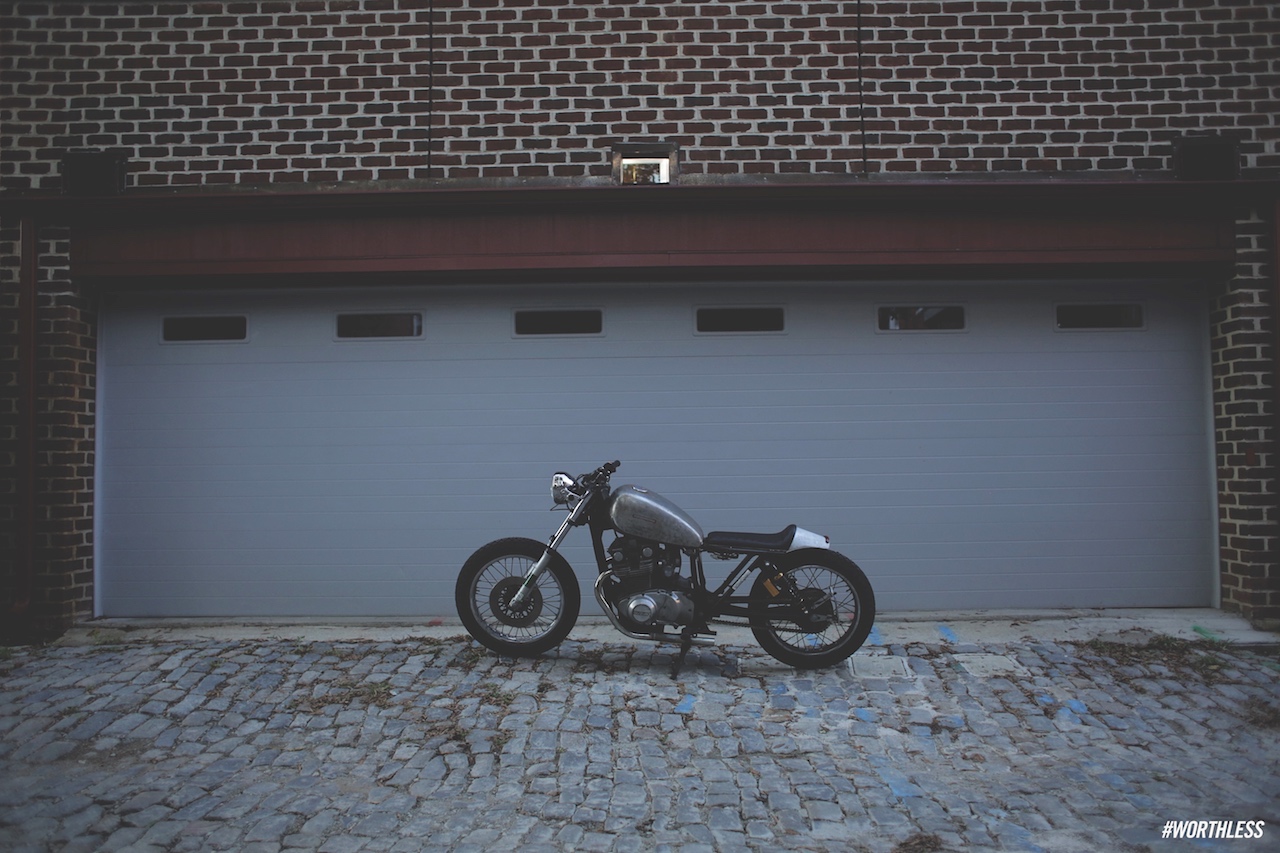

    Time to let you all know about my first motorcycle
    Only picture I have of it when I bought it, although I had already swapped to some mikuni carbs since the stock ones didn't work well enough and the new carbs were pretty cheap.
    How it sits as of today.
